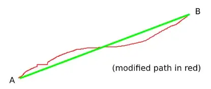

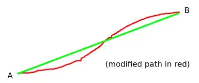

My question is, is $\epsilon$ just a scalar? And if so how can the following two infinitesimal path modifications that have completely different shapes be related by just a scalar? (Apologies for crudely draw diagrams).

The (infinitesimal) parameter $\epsilon$ you have introduced is a scalar and introduced in such a way that for $\epsilon = 0$, the new path $f^*(x)$ is equal to the original path $f(x)$ for which the action is stationary.
The function $\eta(x)$ has the property that it vanishes at $A$ and $B$, i.e. $\eta (A) = \eta(B) = 0$. And the two different path which deviate from $f(x)$ are different due to different $\eta(x)$ for each $f^*(x)$. And therefore you can not relate the two modified path by just a scalar.
