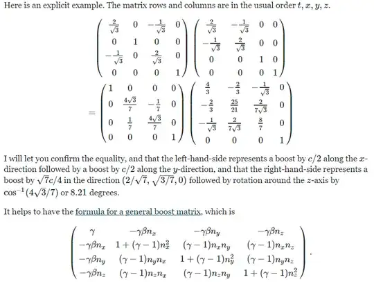

Perhaps not a very bright question (and more of a personal after-thought), but how is one able to interpret or figure out the boost's magnitude (i.e. speed), direction, and rotation (about the z-axis) after a matrix multiplication?
In this "follow-up" thread, I provided below an example given by a helpful expert showing how two perpendicular boosts equal to a rotation after a boost.
Here, in the answer (shown in the image below), I noticed that the author specifically separated his solved answer with two multiplying matrices. While I'm fairly certain that this helps with finding the magnitude, direction, and rotation of the new boost, I am unsure how was the author able to accomplish this and what mathematical tools helped him determine that these two matrices setup will ultimately contribute to the solution process.
Thus, to boil it down simply, here are my two questions:
  1. How can I tell what the new boost's magnitude, direction, and rotation (about the z-axis) are when I have my matrix solution?
  2. How can I appropriately separate a - usually - one matrix solution into two to properly find for the information (i.e. magnitude, direction, and rotation) regarding the new boost?
Perpendicular Boost Matrix Example provided by G. Smith here: https://physics.stackexchange.com/questions/515663/special-relativity-perpendicular-boosts-equaling-to-a-rotation-after-a-boost?noredirect=1
Thank you for reading through this question and I will sincerely appreciate any amount of assistance to help me better understand how to derive the information for the new boost.
Source: Special Relativity - Perpendicular Boosts Equaling to a Rotation after a Boost

Let's see how this works in the example I gave of composing two boosts, $B\left(\frac12, \hat x\right)$ followed by $B\left(\frac12, \hat y\right)$. Multiplying the two boost matrices gives
$$\begin{align} B\left(\frac12, \hat y\right)B\left(\frac12, \hat x\right)&= \left( \begin{array}{cccc} \frac{2}{\sqrt{3}} & 0 & -\frac{1}{\sqrt{3}} & 0 \\ 0 & 1 & 0 & 0 \\ -\frac{1}{\sqrt{3}} & 0 & \frac{2}{\sqrt{3}} & 0 \\ 0 & 0 & 0 & 1 \\ \end{array} \right) \left( \begin{array}{cccc} \frac{2}{\sqrt{3}} & -\frac{1}{\sqrt{3}} & 0 & 0 \\ -\frac{1}{\sqrt{3}} & \frac{2}{\sqrt{3}} & 0 & 0 \\ 0 & 0 & 1 & 0 \\ 0 & 0 & 0 & 1 \\ \end{array} \right)\\ &= \left( \begin{array}{cccc} \frac{4}{3} & -\frac{2}{3} & -\frac{1}{\sqrt{3}} & 0 \\ -\frac{1}{\sqrt{3}} & \frac{2}{\sqrt{3}} & 0 & 0 \\ -\frac{2}{3} & \frac{1}{3} & \frac{2}{\sqrt{3}} & 0 \\ 0 & 0 & 0 & 1 \\ \end{array} \right) \end{align} $$
The matrix on the right (the composition of the two boosts) is clearly not a boost, because it isn't symmetric. And it's clearly not a rotation, because it mixes space and time coordinates. It is a more general Lorentz transformation that is neither a boost nor a rotation but a combination of them.

Once you have extracted the parameters $\beta$ and $\hat n$ for the boost part of a general Lorentz transformation $\Lambda=RB$ from the first row of $\Lambda$, you can use the general boost formula to compute $B$. In our case, it is
$$\begin{align} B&=B\left(\frac{\sqrt{7}}{4},\left(\frac{2}{\sqrt{7}},\frac{\sqrt{3}}{\sqrt{7}},0\right)\right)\\ &= \left( \begin{array}{cccc} \frac{4}{3} & -\frac{2}{3} & -\frac{1}{\sqrt{3}} & 0 \\ -\frac{2}{3} & \frac{25}{21} & \frac{2}{7 \sqrt{3}} & 0 \\ -\frac{1}{\sqrt{3}} & \frac{2}{7 \sqrt{3}} & \frac{8}{7} & 0 \\ 0 & 0 & 0 & 1 \\ \end{array} \right) \end{align} $$
One can then invert it and find the rotation factor $R=\Lambda B^{-1}$.
If you prefer to write a general transformation in the form $\Lambda=BR$, then extract the boot parameters from the first column of $\Lambda$, compute $B$, and then compute $R=B^{-1}\Lambda$.
In either case, computing the inverse boost factor $B^{-1}$ is easy: Rather than actually inverting a $4\times 4$ matrix, you can just reverse the direction of the boost parameter $\hat n$. So in our example,
$$\begin{align} B^{-1}&=\left[B\left(\frac{\sqrt{7}}{4},\left(\frac{2}{\sqrt{7}},\frac{\sqrt{3}}{\sqrt{7}},0\right)\right)\right]^{-1}\\ &=B\left(\frac{\sqrt{7}}{4},\left(-\frac{2}{\sqrt{7}},-\frac{\sqrt{3}}{\sqrt{7}},0\right)\right)\\ &= \left( \begin{array}{cccc} \frac{4}{3} & \frac{2}{3} & \frac{1}{\sqrt{3}} & 0 \\ \frac{2}{3} & \frac{25}{21} & \frac{2}{7 \sqrt{3}} & 0 \\ \frac{1}{\sqrt{3}} & \frac{2}{7 \sqrt{3}} & \frac{8}{7} & 0 \\ 0 & 0 & 0 & 1 \\ \end{array} \right) \end{align}$$
The rotation matrix $R$ satifying $\Lambda=RB$ is then
$$\begin{align} R&=\Lambda B^{-1}\\ &= \left( \begin{array}{cccc} \frac{4}{3} & -\frac{2}{3} & -\frac{1}{\sqrt{3}} & 0 \\ -\frac{1}{\sqrt{3}} & \frac{2}{\sqrt{3}} & 0 & 0 \\ -\frac{2}{3} & \frac{1}{3} & \frac{2}{\sqrt{3}} & 0 \\ 0 & 0 & 0 & 1 \\ \end{array} \right) \left( \begin{array}{cccc} \frac{4}{3} & \frac{2}{3} & \frac{1}{\sqrt{3}} & 0 \\ \frac{2}{3} & \frac{25}{21} & \frac{2}{7 \sqrt{3}} & 0 \\ \frac{1}{\sqrt{3}} & \frac{2}{7 \sqrt{3}} & \frac{8}{7} & 0 \\ 0 & 0 & 0 & 1 \\ \end{array} \right)\\ &= \left( \begin{array}{cccc} 1 & 0 & 0 & 0 \\ 0 & \frac{4 \sqrt{3}}{7} & -\frac{1}{7} & 0 \\ 0 & \frac{1}{7} & \frac{4 \sqrt{3}}{7} & 0 \\ 0 & 0 & 0 & 1 \\ \end{array} \right) \end{align} $$
