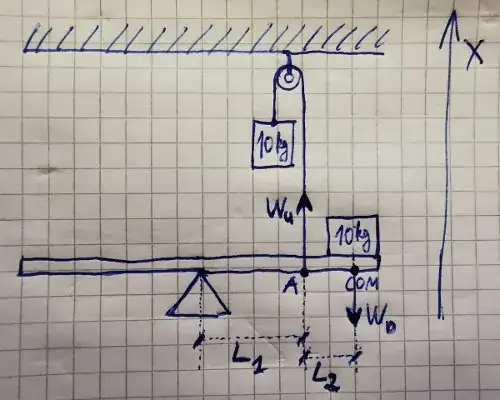

Even if $\vec{F_1}+\vec{F_2}+\dots=0$, $\vec{r_1}\times\vec{F_1}+\vec{r_2}\times\vec{F_2}+\dots$ may not.
One example, consider such lever system : enter image description here
Weights cancels each other : $$ W_U + W_D = 0, $$ however, net toque is $$ \tau = WL_1 - W(L_1 + L_2) = -WL_2. $$ So it is not zero and directed downwards, given that lever will not break at point A
