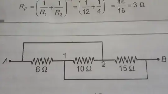

Further in my textbook it is stated that the ends of all three resistors are under the same potential difference. how is that possible?
A is at 10V and is connected by a (perfect 0-resistance, so no voltage drop across it) wire to 2, so 2 is at 10V. B is at 0V and is connected by a wire to 1, so 1 is at 0V. So the potential difference across the $6\Omega$ resistor is the difference between A and 1: 10V. The potential difference across the $15\Omega$ resistor is the difference between 2 and B: 10V. The potential difference across the $10\Omega$ resistor is the difference between 2 and 1: 10V. Now use Ohm's law to find the current through each resistor.
