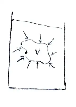

$$\underline{\text{An Intuitive Way to Understand Archimedes' Principle}}$$ Consider the following figure.
It is just a container filled with water (density $\rho_w$) and I have marked a closed surface $S$ inside it of arbitrary shape enclosing volume $V$. I haven't introduced any external object yet. Now, we know that the water outside the enclosed volume exerts pressure on the water inside. The exact pressure distribution on the surface is complicated. But, we do know one thing for sure : the water inside is at equilibrium. This implies the following ($d\mathbf{A}=dA \hat{n}$, where $\hat{n}$ is the inward pointing normal unit vector),
$$\oint_S p d\mathbf{A}=-\rho_w Vg \hat{k} \tag{1}$$
Upon considering the special case of a cylinder to be the closed surface $S$ (so that the pressure distribution on the sides of the cylinder are symmetrical and cancel out), we can find that the pressure distribution varies linearly with height.
Now, replace the water enclosed by $S$ by an object of the exact size and shape. Will the water molecules outside the enclosed volume change their behavior and apply a different pressure distribution simply because you changed the water inside with a different material? No.
Therefore, the force exerted by water on the object will still be equal to $-\rho_w V g \hat{k}$.
$$\underline{\text{Where you went wrong (possibly)}}$$ I believe you're assuming a cylinder as your object. The force exerted on the bottom of the cylinder is not $\pi r^2 h \rho_w + W_{object}$, but instead $\pi r^2 (h+h_{cyl}) \rho_w$. This is also the force exerted by the cylinder on the bottom portion of the water ($\pi r^2 (h+h_{cyl}) \rho_w$ is the action-reaction pair). In short, I believe you have made a mistake in identifying the action-reaction pair.
