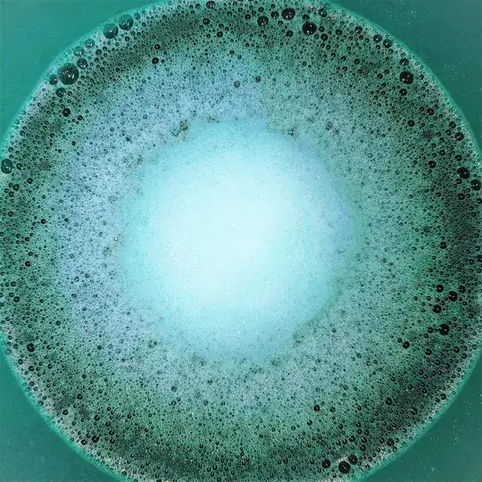

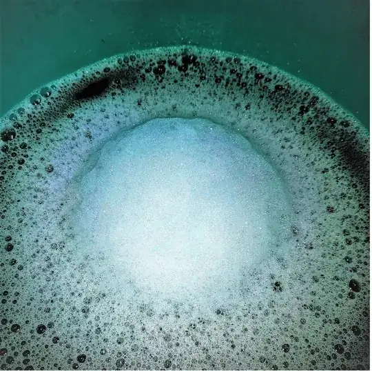

I first noticed this while having a coffee. When the coffee was rotating in the cup, most of its foam accumulated near the centre. I recreated the effect with some soap and water. The accumulated foam formed a beautiful dome. You can see the dome formation in detail in this video.
Side view bucket1
Top view bucket2
I wonder what causes this pattern formation. I would expect the foam to move away from the centre due to centrifugal forces, but that's not what I see. I believe there's something else to it. So here's the question in short:
Why does foam accumulate near the centre of rotating fluids?
Also, why there is a characteristic dome shape for the accumulated foam?

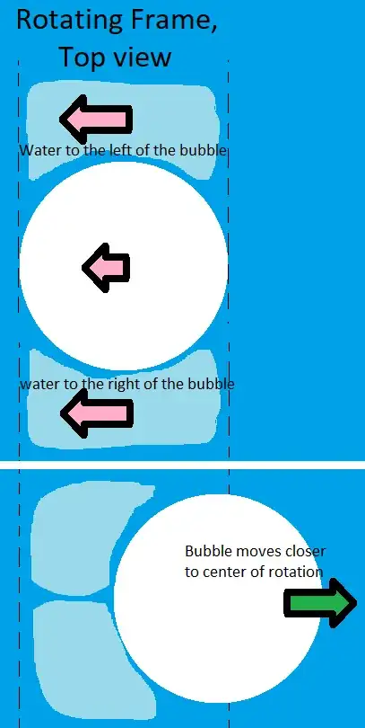

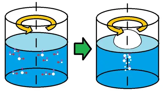

The water experiences a greater centrifugal force than the bubbles
Both the bubbles and the water experience a centrifugal force. However, since the centrifugal force is given by:
$$ F_c = m R \omega ^2 $$
You can see that a more massive object (the water) will experience a greater centrifugal force. From the perspective of the rotating frame, those forces would look like the pink arrows below: bubble rotating frame
Thus the water at the same $R$ as the bubble will flow around the bubble, shoving it closer to the center of rotation. Of course, the bubbles still rise to the surface, so they rise in a pile and cause the bubble bulge in your picture: enter image description here
This is the same principle by which a centrifuge operates, but instead of throwing the heavier material to the outside of the rotating water, it throws the lighter objects towards the center of the rotating water.
