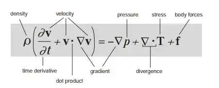

In a nutshell Navier-Stokes equations are a continuum version of Newton's 2nd law. They keep track of how momentum (density) of the fluid change in time.

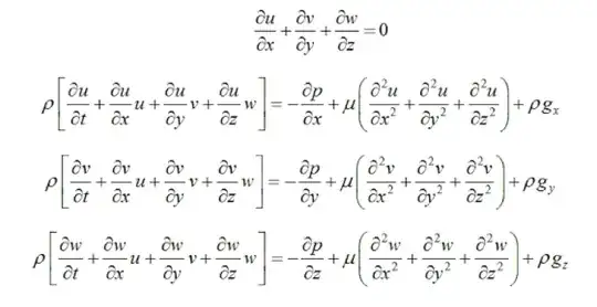

Its just an Equation of motion for Fluid just relatable to Newton's second Law of Motion. Lets start ,
This is the general Expression which can be determined as that, Left hand side is the acceleration of small of region of fluid and right hand side is the forces that act on it,i.e. Pressure,stress and internal body forces. It follows also law of conservation of momentum.These equations are used to solve incompressible or compressible, low or high speed,invisced or viscous flows.
Lets talk about its differential equations for which describe flow of liquids.
The symbol "partial" is is used to indicate partial derivatives. The symbol indicates that we are to hold all of the independent variables fixed, except the variable next to symbol, when computing a derivative. The terms on the left hand side of the momentum equations are called the convection terms of the equations. Convection is a physical process that occurs in a flow of gas in which some property is transported by the ordered motion of the flow. The terms on the right hand side of the momentum equations that are multiplied by the inverse Reynolds number are called the diffusion terms. Diffusion is a physical process that occurs in a flow of gas in which some property is transported by the random motion of the molecules of the gas.Turbulence , Boundary layers , stress these all we study in CFD(computational Fluid Dynamics) come under Diffusion.
Note: They are actually simplifications of the more Euler equations of fluid dynamics. The Euler equations neglect the effects of the viscosity of the fluid which are included in the Navier-Stokes equations.
