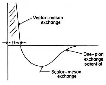

You are assuming the strong nuclear force (residual strong force) is attractive but actually it is distance dependent. At certain, very close distances, it becomes repulsive.
The nuclear potential is attractive at modest distances because the pion interaction gives an attractive potential. It turns repulsive because heavier mesons tend to have unit spin and carry a repulsive force betwen nucleons.
https://physics.stackexchange.com/a/119873/132371
Because of this, the nature of this residual interaction is completely different from the quark-level strong interaction. In particular, note the strong repulsion that happens at distances less than 1 fm (i.e. the diameter of a nucleon). This repulsion, mediated by vector-meson (ρ) exchange, is what keeps protons and neutrons apart.
https://physics.stackexchange.com/a/396054/132371

A nucleon is a composite object made out of three quarks. The nucleon is color-neutral, so to first order, we expect that a nucleon should not interact with another nucleon at all. This is in fact approximately what we do see, since at large distances the nucleon-nucleon interaction falls off exponentially. But the cancellation is not exact, and at small distances we do get an interaction. This is called a residual interaction, and it's exactly analogous to the residual interaction between two electrically neutral atoms, which is the van der Waals force, often modeled by a Lennard-Jones potential.
And the Heisenberg Uncertainty Principle is determining this interaction at very close distances too.
We do not have any usable way of inferring the correct residual interaction between nucleons from a postulated quark-quark interaction. So instead we make models. Some of these models have a repulsive core, and others don't. In particular, it is not necessary to have a repulsive core in order to explain the sizes of nuclei or the fact that they don't collapse; their sizes are fundamentally set by the Heisenberg uncertainty principle.
