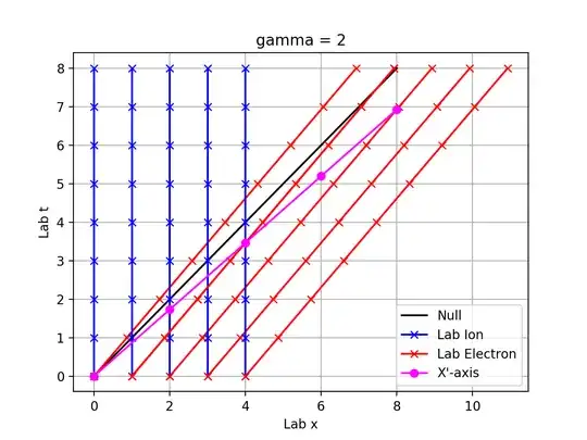

Here is a plot of 5 ions and 5 electrons moving to the right at $\gamma=2$:
Note that in the lab frame the densities are:
$$\rho_{\pm} = \pm 1$$
The magenta line is $t'=0$, aka the $x'$ axis, with uniform symbols at integer values of $x'$. It is easy to see that:
$$ \rho_{\pm} = \gamma^{\pm 1} = 2^{\pm 1} $$

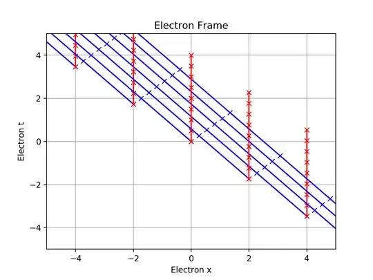

Now I can boost that plot to the electron frame (so the magenta line becomes the abscissa):
That explicitly shows the electron density is reduced by $\gamma$, and the ion lattice contracted by $\gamma$.
