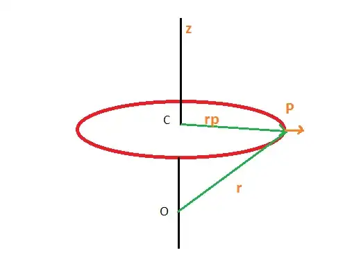

Consider the pure rotation of a 3-dimensional rigid body with respect to an arbitrary axis that might not pass through the center of mass. If this is the case, then every infinitesimal piece of the rigid body is executing a circular motion whose center lies somewhere in this axis.
Diagram
Consider a point $O$ on the axis of rotation, with respect to which we are going to find the angular momentum. It's a figure I got from the internet, so focus on only the labels $O$, $C$, $P$, and the circular orbit. Forget the rest of the inscriptions.
$$d\vec{L}_O = \vec{OP} \times dm \vec{v}=(\vec{OC} + \vec{CP}) \times m \vec{v} = \vec{OC} \times dm \vec{v} + \vec{CP} \times dm \vec{v}$$
Note that both $\vec{CP}$ and $\vec{OC}$ are perpendicular to $\vec{v}$. The component of $d\vec{L}_O$ that is parallel to the axis of rotation comes from the cross product of $\vec{CP}$ with $\vec{v}$. The other one provides the component perpendicular to the axis of rotation. Also $v= CP \omega$ since the rigid body is under pure rotation about the axis.
Let's find the component net angular momentum of the rigid body with respect to point $O$ that is parallel to the axis of rotation. Let's call $\vec{CP}=\vec{r}'$. $$L_z = \int dm CP^2 \omega = \int dm r'^2 \omega = I \omega$$
This component is the same irrespective of the location of the reference point $O$.
This is useful because if we know the component of the net external torque on the rigid body with respect to any point on the axis of rotation parallel to the axis of rotation, we can equate the components to get
$$ I \omega = \tau^{\text{ext}}_{z}$$
The equation $\vec{L} = I \vec{\omega}$ is not true always. And you need to be careful.
