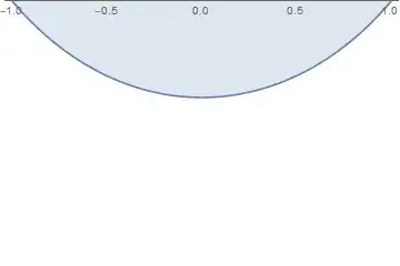

Assuming I have a 2D droplet attached to some surface like so:enter image description here

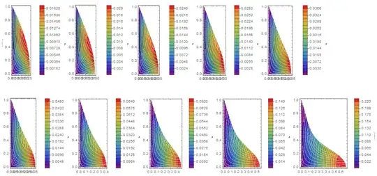

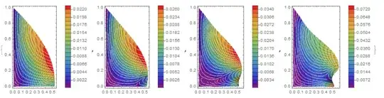

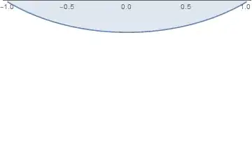

This may help to understand the origin of the adhesion force. I numerically solved the problem of dropping a drop from a solid wall using the system of Navier-Stokes equations and FEM. It was necessary to determine the parameter on which the flow in the drop depends. This parameter is $$W=\frac {\sigma}{d^2\rho g}$$ where $\sigma $ is the surface tension, $d$ is the radius of the drop, $\rho $ is the density, $g$ is the acceleration of gravity. If $W>1$, the drop adheres to the surface, if $W=1$, then the flow is transient, and if $W<1$, then the drop comes off under the influence of gravity. These three flow are shown in Fig. 1; above the figures, $W$ is indicated. Figure I tried to reproduce the following experiment with a drop of honey Figure 2 FEM allows us to describe large deformations, provided that the mesh is calculated at each step. It turns out this picture (shows the flow velocity in cylindrical coordinates for an axisymmetric drop) Figure 3

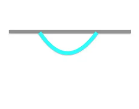

Here I took the small $W = 0.002$. It turned out such a change in the shape of the drop over time Figure 4

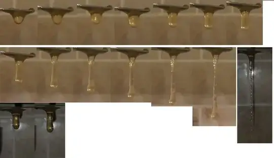

When the surface tension is sufficiently large, then surface instability occurs, as in this example, with $W = 0.1$ Figure 5
