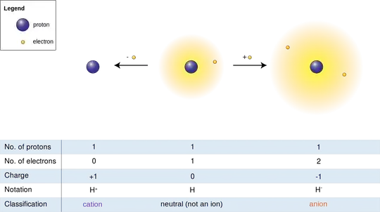

Is there a limit of electrons a single hydrogen atom can have? If so what is it? why? Is the the answer to why scalable to helium?

By definition, "hydrogen atom" refers to the neutral system with one proton and one electron, so it cannot hold any extra electrons.
However, protons can hold more than one electron, in which case the system is termed a hydrogen anion. This is a stable, bound system, and the reaction $$ \mathrm{H}+e^- \to \mathrm{H}^- \tag 1 $$ releases about $0.75\:\rm eV$ (an energy known as the electron affinity of the hydrogen atom), plus whatever kinetic energy the electron came in with, through the emission of a photon.
(As an aside, the hydrogen anion, and particularly the reaction $(1)$ above together with its converse in the form of photodetachment, is incredibly important ─ this is the reason why the Sun's spectrum is continuous.)
Free atoms of most elements tend to have positive electron affinities, which means that their singly-charged negative anions are stable systems, and they release energy when they capture their first extra electron. There's a few exceptions, though, starting with helium: atoms which have stable closed shells can 'reject' that extra electron, as it's forbidden from sitting in the closed valence shells and it's forced to sit at higher-energy shells that are too far uphill in energy to be stable.
If you want to up the game and go to a second extra electron, though, to get to $\rm H^{2-}$, the game runs out, and indeed it runs out for every element ─ all the second electron affinities are negative. That is, it takes work to cram a second extra electron in, and the resulting dianion will at best be in a metastable state that's ready and jumping to give that energy back out by dissociating into the single anion and a free electron. It's just too hard to try and hold two extra electrons (and their resulting mutual electrostatic repulsion) within the confines of an atomic system.
