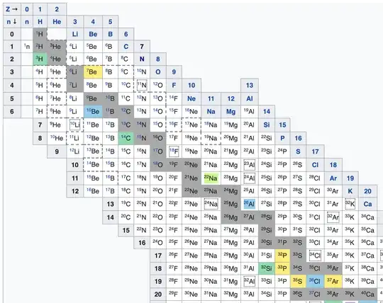

What you are looking for is isotopes with neutron–proton ratio N/Z less than 1. You can find these isotopes, for example, in this list from Wikipedia. As you can see, you are looking for members of the table with N less than Z.
In these table you are looking for isotopes that are roughly above the gray zone (also known as band or belt of stability).
The colors indicate how stable the isotopes are, grey isotopes are stable, white isotopes have a half-life of less than a day, other colors are somewhere in-between. According to the table there are only three isotopes with less neutrons than protons and a half-life of more than a day. hydrogen-1 and helium-3 which are stable and beryllium-7 with a half-life of around 53 days.
