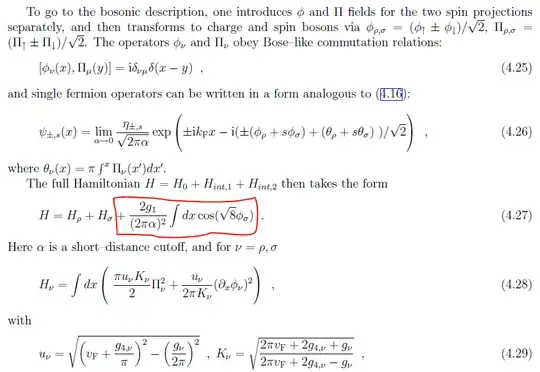

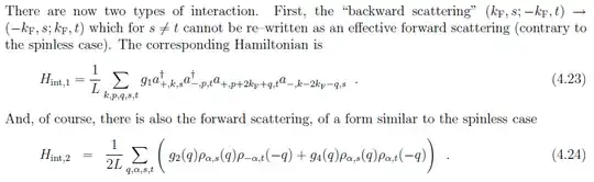

I am currently reading "Fermi liquids and Luttinger liquids" by Schulz (https://arxiv.org/abs/cond-mat/9807366). In page 27 it says the following:
My question is about how $$\frac{g_1}{(2\pi\alpha)^2} \int dx \cos(\sqrt 8 \phi_\sigma)$$ arises in (4.27), which is the bosonized form of (4.23). In this article, Bosonization convention is as follows:
