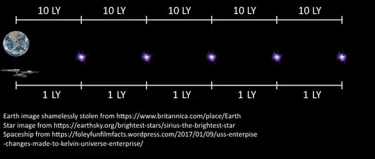

Take, for example, an interstellar spaceship traveling 0.995c relative to Earth. This gives a Lorentz factor, γ (gamma), of 10. Now, the spaceship is traveling in some direction in a straight line. Conveniently, there are a bunch of stars along that line at consistent intervals.
Suppose Earth is able to broadcast powerful radio signals towards the stars and record the reflected signals. The radio signals take 20 years to bounce off the first star, 40 years for the second, etc. Using the time delay between signals, Earth determines the first star is 10 light years away, and each subsequent star is 10 light years from the previous star.
Now, the spaceship passes by Earth at the exact moment one of the broadcasts goes out. Because the spaceship is moving towards the stars, it will take less time for the return signal to get to the spaceship. So we'd calculate the same time out, and a (much) lower time back. Then we divide this time by the Lorentz factor to get the perceived time.
Earth and spaceship looking at a series of stars with Earth perceiving ten light years between stars and the spaceship perceiving half a light year between stars.

Because the round-trip signal takes an apparent 1 year, the spaceship might measure the distance between stars as being half a light year. However, repeated measurements would also show that the stars are moving towards the spaceship at nearly the speed of light, meaning light only travels half the distance before bouncing back (the radio signal goes out at about the same speed as the stars are coming in, so they meet in the middle). Thus, the spaceship would conclude the stars are 1 light year apart and moving quite quickly.
I'm too lazy to do the full math right now, but it should turn out that for any given time dilation, the apparent distance between two objects will be lower by the exact same factor. In this case, a Lorentz factor of 10 means Earth will simultaneously perceive the time taken to be 10 times longer, and the distance traveled to be 10 times farther.

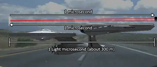

Instead of using light years, let's bring that down to light microseconds, or about 300 meters. Conveniently, our spaceship is about 300 meters long. (Says this site and Wikipedia, not that it matters.)
So when our spaceship is sitting on Earth, we put a mirror on the front and a laser pointer and detector on the back, activate the laser, and time how long the laser takes to bounce off the mirror and return to the detector. It takes 2 μs for the signal to hit the mirror and return, so we measure the spaceship to be 1 Lμs long. Which is obvious, because that's how we set up the problem.
Spaceship sitting on Earth. Light takes one microsecond each direction.

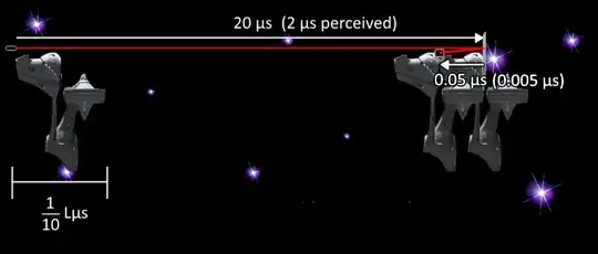

Now, we accelerate the spaceship to 0.995c, which gives a Lorentz factor of 10, as noted above. The light is just barely going faster than the mirror up front, so it takes a long time to get there. Then the return trip is almost instantaneous since the detector and light are moving in opposite directions. After calculating the total, we modify it for time dilation to get the perceived time taken.
Spaceship flying through space appears a tenth the length. Light takes twenty microseconds one way, perceived as two microseconds, and almost nothing the other way.

But now we have to take a step back. There's an error here that's non-obvious (to me, anyway). We presumed the distance between the front and back remains the same when the spaceship starts moving. But, for the same reason the stars appear to be closer together in the first example, the spaceship, as measured from Earth, will appear to have contracted along its velocity axis. So we divide the measured resting distance by the Lorentz factor so all the moving values are proper according to Earth's reference frame.

The distance will thus be measured as just over 1Lμs from the spaceship, which is what we expected based on our Earth measurements.
As above, I'm fairly certain there's some math I'm missing that makes the distance exactly equal no matter your reference frame, instead of being a couple percent off, but I'm not sure where the error is.
