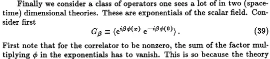

I am currently reading Shankar's "Bosonization: How to make it work for you in condensed matter" (http://inspirehep.net/record/408901/). In page 9, I am stuck with computing the correlation function in (39).

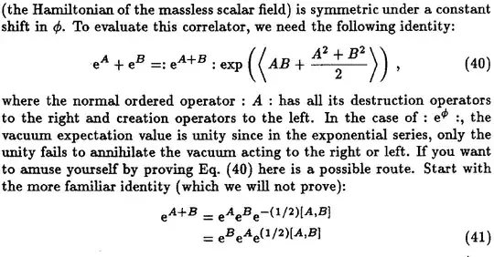

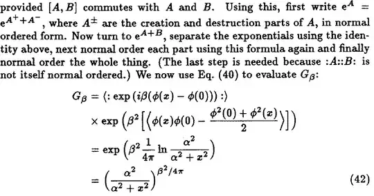

My question is about deriving (40). Following the guide given in few lines below the article, I found out $$:e^A: = :e^{A^++A^-}:=e^{A^+}e^{A^-}$$ but how can I proceed to (40). Moreover, if I just assume (40), I cannot understand (42). Letting $A=i\beta\phi(x), \quad B=i\beta\phi(0)$ and using (40) gives $$e^{i\beta\phi(x)}+e^{-i\beta\phi(0)}=:ie^{i\beta(\phi(x)-\phi(0))}: \exp\left(\beta^2\langle \phi(x)\phi(0)-\frac{\phi(x)^2+\phi(0)^2}{2}\rangle\right).$$ How can I match this with (42)?

Equation 40 should read (a correct version can be found can be found in Shankars book) $$ e^Ae^B = :e^{A+B}: e^{\left\langle AB + \frac{1}{2}\left(A^2+B^2\right)\right\rangle} $$ The procedure is essentiall laid out in the paragraphs under eq.(40); given $A$ and $B$ commute with $[A,B]$, we have eq.(41) (this can be derived as a special case of the Baker-Campbell-Haausdorff formula) \begin{align} e^{A+B} &= e^A e^B e^{-\frac{1}{2}[A,B]}\\ &= e^B e^A e^{\frac{1}{2}[A,B]}\;. \end{align} We can now write $A = A^+ + A^-$ interms of creation and destruction parts (and similarly $B$) and use the above expression to reorder terms until we arrive at the normal ordered expression $:e^{A+B}:$ multiplied by a bunch of commutators.
Finally we note that \begin{align} \langle C D \rangle &= \langle (C^++C^-)(D^++D^-) \rangle\\ &=\langle C^-D^+\rangle \\ &= [C^-,D^+] \end{align} and use this to write the commutators in terms of the vacuum expectation values to obtain the final result.
