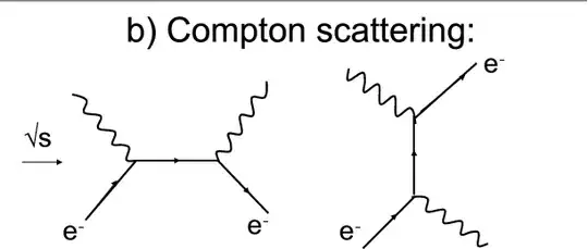

The electron does not absorb a photon. A free electron interacts with a photon according to quantum electrodynamic rules, and it is not a classical electrodynamics acceleration or deceleration. An electron bound to matter changes energy levels and the photon is absorbed or emitted from the atom/molecule/lattice. All these interactions are calculable with Feynman diagrams.
compt
For example these are the first order diagrams that contribute to the free electrom photon interaction that can be used to give the probability of interaction and statistical plots of energy and momentum.
