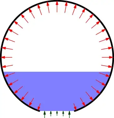

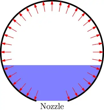

In the image below, it seems that the thrust on the rocket should be equal to the force imbalance as shown by the arrows. This force imbalance is the internal gage pressure times the nozzle area.
$F=AP$

Based on all the great answers and comments, I think the following figure is a better representation of the thrust force. Internal pressure (red arrows) drops off near the nozzle opening because the water flow speed is significant. Also, the water at the nozzle opening is not at zero pressure as I had originally assumed. Instead, there is dynamic pressure (green arrows) that is inversely proportional to the flow velocity. The force imbalance equals double the air pressure times the nozzle area, $F=2AP$.

The first method is correct. In the second you have assumed that the pressure at the nozzle is still $P$ despite the water exiting with some velocity. i.e. You have neglected the dynamic pressure.
You need to use Bernoulli's principle $$ P + \frac{\rho v^2}{2} + \rho h g = {\rm constant}$$
Your first method assumes that the top surface of the water is hardly moving (because it's surface area is much bigger than the nozzle area). Applying the same idea to the second method, then we can calculate the constant both in the water and immediately below the nozzle as $$P = P_A + \frac{\rho v^2}{2},$$ where $P_A$ is atmospheric pressure and we neglect the small $\rho h g$ term which increases pressure due to to the column of liquid above the nozzle on the LHS. If we further assume that $P \gg P_A$ then $P = \rho v^2/2$ and the rate of change of momentum of liquid from the nozzle is $$ F = \rho A v^2 = 2PA$$

The pressure drop from tank pressure to atmospheric pressure does not occur instantly at the nozzle but rather is spread out according to the area of the flow channel. This reduced pressure results in additional thrust that was not accounted for in your second solution. Here is one way to calculate this additional missing thrust:
Bernoulli's equation (your second to last equation) applies:
$$P+\frac12\rho v^2 = constant$$
we can combine this with your mass flow equation to get:
$$P+\frac12\rho \left(\frac{\dot m}{\rho A}\right)^2 = constant$$
Your original answer assumes negligible velocity/large area at the water surface1:
$$P_{tank} + 0 = constant$$
This gives us our constant:
$$P+\frac12\rho \left(\frac{\dot m}{\rho A}\right)^2 = P_{tank}$$
and we know the pressure at the exit is atmospheric/ 0 gauge pressure:
$$0 + \frac12\rho \left(\frac{\dot m}{\rho A_{exit}}\right)^2 = P_{tank}$$
We can solve for $\dot m$:
$$\dot m = A_{exit}\sqrt{2 \rho P_{tank}}$$
Plugging back in:
$$P+P_{tank}\left(\frac{A_{exit}}{A}\right)^2 = P_{tank}$$
Solving for pressure:
$$P = P_{tank} \left(1-\left(\frac{A_{exit}}{A}\right)^2\right)$$
So if we wanted to calculate the additional thrust due to the pressure ebeing lower near the nozzle we'd need to integrate the pressure by the area:
$$F = F_{up} - F_{down} = \int_{A_{exit}}^\infty \left (P_{tank} - P_{tank} \left(1-\left(\frac{A_{exit}}{A}\right)^2\right) \right) \; dA $$
$$F = P_{tank} \int_{A_{exit}}^\infty \frac{{A_{exit}}^2}{A^2} \; dA $$
$$F = P_{tank} A_{exit} $$
So there's the missing $PA$ from your second solution.

As you have neglected atmospheric pressure, let's assume that you are doing the experiment in a vacuum(I know that there is a spherical cow analogy somewhere :) ). You are assuming that the pressure is exerted by air inside the ballon at the surface. The air will exert the pressure in the empty part as shown by your arrows as well as on the horizontal surface of the water. Now, this will cancel out due to a complete loop. Now, if the balloon was closed there would have been no net force as the downward force due to air pressure would have been balanced by the normal force. In your 1st method, the pressure you have taken is the air pressure present inside the ballon. In your second method, you are assuming the same pressure at the bottom of the nozzle which is incorrect.

There is a simple intuitive explanation for the factor of two difference. The thrust has two contributions, as follows.
1) The air pressure in the rocket imposes a force down the nozzle of F=PA exactly as you surmised in your second method.
2) The exhaust water at the instant it leaves the nozzle is still pressurised, and imposes a back-pressure on the rocket. The force due to the back pressure is also straightforwardly F=PA.
The combined effect is therefore 2PA.
