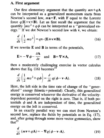

I am trying to understand the magnetic vector potential as momentum per unit charge, that is, somehow, the "total" momentum should be $p = mv +qA$.
Here's a part of the paper I was reading - I am facing difficulties understanding the mathematical gymnastics involved, and would appreciate any help! enter image description here
Firstly, let's start with (16). On the RHS, the dot product of velocity with $v$ x $B$ is zero, and only the first term remains. To arrive at (18) from (16), I added the time derivative of $q\phi$ on both sides - the LHS is now what is desired, so manipulation on RHS should yield the RHS of (18); and this is where I'm stuck. How should I take it from here? Please help! A detailed explanation would be great. I'm using Griffiths as the text for my E&M course, and I am only familiar with the level of vector calculus used in the book, and that is probably why I'm stuck where I am.
Also, I need help deriving (19) (trust me, I tried).
Lastly, what is the difference between $p = mv$ and $p = mv + qA$? We call both as momentum, and I'd learnt only the former in a classical mechanics course. So what is the difference in meaning and interpretation of the two different momenta? I am really interested in understanding this concept - vector potential as momentum per unit charge, please help me out! Also, this is a very absorbing concept, one that isn't touched upon in nearly all E&M texts, so this post, when complete with answers, would definitely interest many people on Physics SE!
Here's the link to the entire paper, if the readers would like to know more: Thoughts on the magnetic vector potential
First the derivations:
Equation 18:
The connection between total time derivative $\frac{d}{dt}$ and partial time derivative $\frac{\partial}{\partial t}$ of a scalar function is, using the chain rule,
$$ \frac{d}{dt} = \frac{\partial}{\partial t} + \frac{\partial x}{\partial t} \frac{\partial}{\partial x} + \frac{\partial y}{\partial t} \frac{\partial}{\partial y} + \frac{\partial z}{\partial t} \frac{\partial}{\partial z} $$
Notice that this is equal to
$$ \frac{d}{dt} = \frac{\partial}{\partial t} + \mathbf{v} \cdot \nabla $$
Hence $q \frac{d \phi}{dt} = q \frac{\partial \phi}{\partial t} + q \mathbf{v} \cdot \nabla \phi$, where the last term is the one appearing in Eq. 16, but with a minus sign.
From this we get
$$ \frac{d}{dt} \left( \frac{1}{2} m v^2 \right) = -q \mathbf{v} \cdot \nabla \phi - q \mathbf{v} \cdot \frac{\partial \mathbf{A}}{\partial t}$$
$$ \frac{d}{dt} \left( \frac{1}{2} m v^2 \right) = q \frac{\partial \phi}{\partial t} - q \frac{d \phi}{dt} - q \mathbf{v} \cdot \frac{\partial \mathbf{A}}{\partial t} $$
$$ \frac{d}{dt} \left( \frac{1}{2} m v^2 \right) + q \frac{d \phi}{dt} = q \frac{\partial \phi}{\partial t} - q \mathbf{v} \cdot \frac{\partial \mathbf{A}}{\partial t}$$
$$ \frac{d}{dt} \left(\frac{1}{2} m v^2 + q \phi \right) = q \left(\frac{\partial \phi}{\partial t} - \mathbf{v} \cdot \frac{\partial \mathbf{A}}{\partial t} \right)$$
which is what I think Eq. 18 is supposed to be. Here it is also perfectly clear that if $\phi, \mathbf{A}$ are not explicitly time dependent, then their partial time derivatives are 0, and the whole RHS is zero.
Equation 19:
Here we need the total time derivative of a vector function $\mathbf{A}$. By looking at the components of the vector, we should realize that
$$\frac{d \mathbf{A}}{dt} = \frac{\partial \mathbf{A}}{\partial t} + \left( \mathbf{v} \cdot \nabla \right) \mathbf{A} $$
with the interpretation that e.g.
$$ \frac{d A_x}{dt} = \frac{\partial A_x}{\partial t} + \frac{\partial x}{\partial t} \frac{\partial A_x}{\partial x} + \frac{\partial y}{\partial t} \frac{\partial A_x}{\partial y} + \frac{\partial z}{\partial t} \frac{\partial A_x}{\partial z} $$
We have a useful vector calculus identity link:
$$ \mathbf{v} \times (\nabla \times \mathbf{A}) = \nabla_\mathbf{A} (\mathbf{v} \cdot \mathbf{A}) - (\mathbf{v} \cdot \nabla) \mathbf{A} $$
where the notation $\nabla_\mathbf{A}$ means only the variation due to $\mathbf{A}$ is taken into account in that term.
Starting from Newton's second law, $\frac{d}{dt}(m \mathbf{v} ) = q(\mathbf{E} + \mathbf{v} \times \mathbf{B})$ and inserting the potentials, we get
$$ \frac{d}{dt}(m \mathbf{v} ) = q \left(- \nabla \phi - \frac{\partial \mathbf{A}}{\partial t} + \mathbf{v} \times (\nabla \times \mathbf{A}) \right) $$
Using the identity gives
$$ \frac{d}{dt}(m \mathbf{v} ) = q \left(- \nabla \phi - \frac{\partial \mathbf{A}}{\partial t} + \nabla_\mathbf{A} (\mathbf{v} \cdot \mathbf{A}) - (\mathbf{v} \cdot \nabla) \mathbf{A} \right) $$
$$ \frac{d}{dt}(m \mathbf{v} ) + q \left( \frac{\partial \mathbf{A}}{\partial t} + (\mathbf{v} \cdot \nabla) \mathbf{A} \right) = q \left(- \nabla \phi + \nabla_\mathbf{A} (\mathbf{v} \cdot \mathbf{A}) \right) $$
On the LHS we identify the total derivative of the vector potential, so finally
$$ \frac{d}{dt} \left( m \mathbf{v} + q \mathbf{A} \right) = - q \nabla \left(\phi - \mathbf{v} \cdot \mathbf{A} \right) $$
where the gradient on the RHS is understood in accordance to the clarification about the identity we used.

From the linked paper, $$\frac{d}{dt} \left( \frac{1}{2} mv^2 \right) = q \mathbf v \cdot (\mathbf E + \mathbf v \times \mathbf B) \label{16}\tag{16}$$
$$\mathbf E = - \nabla \phi - \frac{\partial}{\partial t} \mathbf A\ \text{ and }\ \mathbf B = \nabla \times \mathbf A \label{17}\tag{17}$$
I assume when taking the total derivative of $\phi$, the following was meant: $$q \frac{d}{dt} \phi(\mathbf r,t) = q \frac{\partial}{\partial t} \phi + q \mathbf v \cdot \nabla \phi \label{n.1}\tag{n.1}$$
If we dot \ref{17}.a with $q \mathbf v$, we get $$q \mathbf v \cdot \mathbf E = - q \mathbf v \cdot \nabla \phi - q \mathbf v \cdot \frac{\partial}{\partial t} \mathbf A$$
Substituting $- q \mathbf v \cdot \nabla \phi$ from \ref{n.1} $$q \mathbf v \cdot \mathbf E = - q \frac{d}{dt} \phi + q \frac{\partial}{\partial t} \phi - q \mathbf v \cdot \frac{\partial}{\partial t} \mathbf A$$
From \ref{16}, we have $$\frac{d}{dt} \left( \frac{1}{2} mv^2 \right) = q \mathbf v \cdot (\mathbf E + \mathbf v \times \mathbf B) = q \mathbf v \cdot \mathbf E$$
since $\mathbf v \cdot (\mathbf v \times \mathbf B) = 0$. We already calculated $q \mathbf v \cdot \mathbf E$: $$\frac{d}{dt} \left( \frac{1}{2} mv^2 \right) = - q \frac{d}{dt} \phi + q \frac{\partial}{\partial t} \phi - q \mathbf v \cdot \frac{\partial}{\partial t} \mathbf A$$
$$\frac{d}{dt} \left( \frac{1}{2} mv^2 + q \phi \right) = q \frac{\partial}{\partial t} \phi - q \mathbf v \cdot \frac{\partial}{\partial t} \mathbf A$$
$$\frac{d}{dt} \left( \frac{1}{2} mv^2 + q \phi \right) = \frac{\partial}{\partial t} q (\phi - \mathbf v \cdot \mathbf A) \tag{18}$$ $$\tag*{$\blacksquare$}$$
$$\frac{d}{dt} (m \mathbf v + q \mathbf A) = - \nabla q (\phi-\mathbf v \cdot \mathbf A) \label{19}\tag{19}$$
For \ref{19}, you need to use (again, I am not sure about this) $$q \frac{d}{dt} \mathbf A = q \frac{\partial}{\partial t} \mathbf A + q (\mathbf v \cdot \nabla) \mathbf A \label{n.2}\tag{n.2}$$
From $\mathbf F = m \mathbf a = m \frac{d}{dt} \mathbf v = q(\mathbf E + \mathbf v \times \mathbf B)$, $$m \frac{d}{dt} \mathbf v = q(\mathbf E + \mathbf v \times \mathbf B)$$
Adding both sides $\frac{d}{dt} q \mathbf A$, $$\frac{d}{dt} (m \mathbf v + q \mathbf A) = q(\mathbf E + \mathbf v \times \mathbf B + \frac{\partial}{\partial t} \mathbf A + (\mathbf v \cdot \nabla) \mathbf A) \label{n.3}\tag{n.3}$$
Using $\mathbf A \times (\mathbf B \times \mathbf C) = (\mathbf A \times \mathbf C) \mathbf B - (\mathbf A \times \mathbf B) \mathbf C$ and \ref{17}.b, $$\mathbf v \times \mathbf B = \mathbf v \times (\nabla \times \mathbf A) = \nabla (\mathbf v \cdot \mathbf A) - (\mathbf v \cdot \nabla) \mathbf A$$
Inserting this into \ref{n.3}, $$\frac{d}{dt} (m \mathbf v + q \mathbf A) = q(\mathbf E + \frac{\partial}{\partial t} \mathbf A + \nabla (\mathbf v \cdot \mathbf A))$$
Using \ref{17}.a, we have $\mathbf E + \frac{\partial}{\partial t} \mathbf A = - \nabla \phi$, so $$\frac{d}{dt} (m \mathbf v + q \mathbf A) = - q(\nabla \phi - \nabla (\mathbf v \cdot \mathbf A))$$
$$\frac{d}{dt} (m \mathbf v + q \mathbf A) = - \nabla q (\phi-\mathbf v \cdot \mathbf A)$$ $$\tag*{$\blacksquare$}$$

The potential energy deu to the Lorenz force is (Goldstein book):
$$U=q\,\phi(x)-q\,A(x,t)\cdot\,v(t)$$
and the kinetic energy is:
$$T=\frac{1}{2}\,m\,v^2$$
so the total energy $E=T+U$ is explicit independent from t,so:
$$\frac{d}{dt}\,E=0=\frac{d}{dt}\left(\frac{1}{2}\,m\,v^2+q\,\phi(x)-q\,A(x,t)\cdot\,v(t)\right)$$ or: $$\frac{d}{dt}\left(\frac{1}{2}\,m\,v^2+q\,\phi(x)-\underbrace{q\,\phi(x)}_{\ne f(t)}-q\,A(x,t)\cdot\,v(t)\right)=0$$
$\Rightarrow\quad$equation (18)
with:
$$L=T-U=\frac{1}{2}\,m\,v^2-q\,\phi(x)+q\,A(x,t)\cdot\,v(t)$$
the equations of motion
$$\frac{d}{dt}\left(\frac{\partial L}{\partial v}\right)+\frac{\partial L}{\partial x}=0$$
$\Rightarrow$
$$\frac{\partial L}{\partial v}=m\,v+q\,A$$
$$\frac{\partial L}{\partial x} =\frac{\partial }{\partial x} \left[q\,(\phi-A\cdot v)\right]$$
$\Rightarrow\quad$equation (19)
