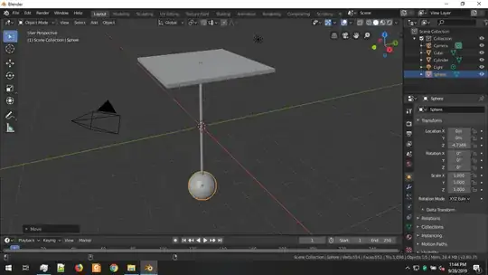

I have I have some objects assembled like this :
The inertia tensor would be :
$$I=I_1+I_2+I_3-m_1 \,\tilde{r}_{01}\,\tilde{r}_{01}-m_3\,\,\tilde{r}_{03}\,\tilde{r}_{03}$$
Where :
$$\tilde{r}_{01}=\begin{bmatrix} 0 & -z & 0 \\ z & 0 & 0 \\ 0 & 0 & 0 \\ \end{bmatrix}$$
and $$\tilde{r}_{03}=\begin{bmatrix} 0 & +z & 0 \\ -z & 0 & 0 \\ 0 & 0 & 0 \\ \end{bmatrix}$$
According to this.
Detailed notations here.
But what is the inertia if -
  • I rotate the planar object on the very top(everything with it) around $Z$-axis
  • Just rotate the rod and sphere (except the planar object), just like a pendulum. Let angle with $X$-axis is $\alpha$ and angle with $Y$-axis is $\beta$
  • Do both together
