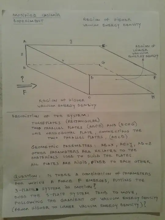

I have the following configuration, related to a modified Casimir experiment.  We have two parallel metal plates and an orthogonal metal plate connecting the two parallel plates. Note that this is very close to the experimental setup of the original Casimir experiment, except for the orthogonal plate (connecting the two parallel plates at one end). I would like to know all the Casimir  forces that exist in this configuration.
For clarification, you can see the following picture:
My naive intuition could be incorrect, but my impression is that the asymmetric radiation  pressure due to quantum fluctuations would lead to the emergence of a certain force (parallel to the parallel plates), but I don't know if the QFT / QED calculations justify my intuition (where in fact  these virtual particles are just an intuitive representation of links in Feynman diagrams, linked to terms in infinite perturbation series).

It would be a nice experiment to make. I could say that an uniform Lorentz-invariant vacuum energy density must look like $\rho(\omega) \propto \omega^3$, so it should locally appear to be mostly condensed in modes that are shorter than your cavity. If you want to make the force observable, you need the cavities to be as tightly-packed as your engineering permits. I don't think this particular setup has been attempted because it is extremely hard to measure without zero gravity.
