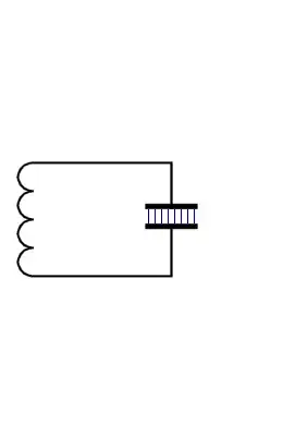

Dipole antennas
It was Heinrich Hertz, student of Kirchhoff and Helmholtz who tried to verify Maxwells equations by generating electromagnetic radiation building a dipole antenna out of a somehow transformed RLC-circuit: emerging of a dipole
This is the physical ground on which we have to investigate your question to get an idea if optical antennas are possible and if you could use some of your ones to create red light. So let's look at the characteristic value of such an antenna: its length.

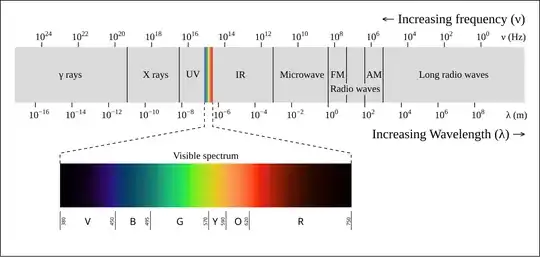

If you look at the electromagnetic spectrum,
EM-Spec
red light has a wavelength of about 600 to 700nm, your antenna will have $$L\approx 300nm$$ which is incredibly small. This is the reason, antennas in optical frequencies are subject to current research, see e.g. Resonant Optical Antennas by Mühlschlegel et al.
So, from this point of view it seems very unlikely that a Layman will be able to produce an antenna that can emit light at optical frequencies.
