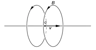

I continue to thinking about all this mess even if no-one seems to have an explanation for me ^^ Maybe it could be fine to introduce the Poynting vector $\mathbf{S} \propto \mathbf{E}\times\mathbf{B}$ which is the flux of energy (per area per time). If we rely of the picture of an uniformly moving charge :
$\hskip2in$Feynman representation's of an uniformly moving charge $\hskip2in$Take from Feynman Lectures : $\hskip2in$http://www.feynmanlectures.caltech.edu/II_26.html
We have a Poynting vector $\mathbf{S}$ which non-zero near the particle trajectory. If my particle is now a plane, the "3d near field" doesn't decrease $\propto 1/R^2$. There is two way to speak about this :
  • E-Field and B-Field are constant in space and so are not null when $x=+\infty$. $S \neq 0$ when $x=+\infty$. The Poynting vector is "not attach" to the trajectory of the particle.
  • $+\infty$ doesn't existe anymore, where are really, really, really near the sheet/particle.
So we have energy every where in space. But what is this energy ?

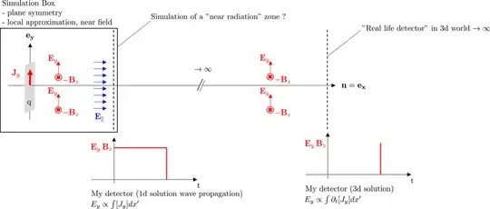

Eventually, if we are an observer in an other inertial frame, say $R’$, which is moving at the velocity $v_y$ with respect to the initial $R$ frame. At the beginning, we see a moving charge. But as soon the charge is moving in $R$, it is at rest in $R’$. The only space-time event (cause) which seems give (to me) the same consequence in the two inertial frame is the acceleration of the charge (starting in $R$, stopping in $R’$) related in 3d to an electromagnetic field emission/photon emission/radiation.

First it doesn't seem very serious to say : "E-field" and "B-field" live together without seing each other even if they are present near the current sheet. In reality there are one E-field and one B-field and these two represent one entity. So near a current sheet, there is a Poynting vector. There is radiation. With 0 frequency maybe but... no importance.
Next for my problem... The initial question was asked to resolve a paradox between a 2D Particle-In-Cell simulation with local planar symmetry and field which are recorded far from the sources.
links between simulation experiment results
A plane wave come accelerate a plasma sheet (for example Au or Al completely ionized). The current induce by the incoming laser produce waves, fields, energy. When we solve the 1D propagation wave, we have so :
$$ E_y = \int [J_y]dx' $$
And that is exactly I record in my simulation. Unfortunately, my simulation produce a result as we are in the "near zone/fresnel zone". I want compare my results with experiment result, because I'm a good guy who want discuss with my teammate who do experiment.
So I say : "Ok guys in fact you record what acceleration do on particle, following Lienard Wiechert and Jefimenko equation. For you, it's a electromagnetic wave. Although for me, acceleration process are hidden not in the wave but in the wavefront." So if I use the solution for 1d wave equation :
$$\underbrace{\partial_t E_y = \partial_t \int[J_y]dx'}_{\text{1D wavefront}} \equiv \overbrace{E_y = \int \partial_t[J_y]dx'}^{\text{3D wave}}$$
All other energy of my simulation is bound to the source. In the near zone, if my current sheet is accelerated, it will create a lot of wavefront. Theses wavefronts produce time after time give birth to a wave when we evaluate field and energy $\rightarrow \infty$
The problem is :
$$ \partial_t E_y^{1D} \rightarrow i\omega\tilde{E}_y^{1D}(\omega) \equiv \tilde{E}_y^{3D} $$
in the Fourier Space. I don't know if we have this factor in the real far field in the spectrum.
