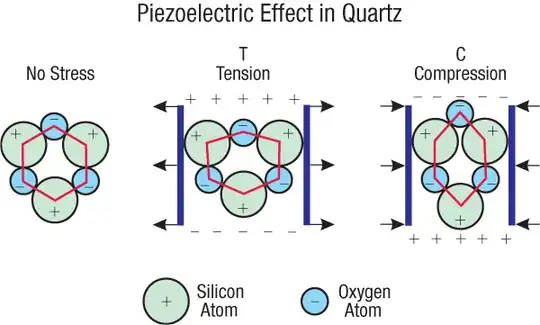

  • In essence, in the piezoelectric element you have an atomic structure of the unit cell which skews the charge distribution towards one side when it is mechanically "squeezed". See this nice illustration from this source:

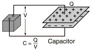

  • A capacitor on the other hand is "filled up" with charges when connected to a battery or other voltage source. Charges of opposite sign will place themselves on either of the capacitor's plates. Illustration from this source:
The result in both of these is now that you have a positive net charge on one side and a negative net charge on the other, while there is no conducting material in-between through which charge can move. So, current can't flow through them, but they nevertheless are able to drive current as a voltage source because of their net voltage across their oppositely charged sides - much like a battery, albeit their voltages will vary very differently over time.
