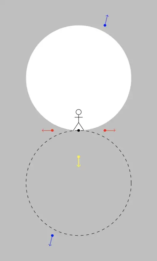

Answer #1: The person experiences earth-like gravity.
This answer argues that for almost every particle in the universe (shown below in blue and red) there is a particle in the "opposite" position which creates an equal and opposite pull. Except for that the particles in an earth-sized sphere right underneath the person (shown in yellow) don't have "opposite" particles, so the net force the person experiences is due to the particles in the earth-sized sphere underneath them.
answer 1
