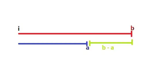

The potential energy at the reference point $i$ was cancelled out! I have tried to visualise why this happens with a one dimensional example (and if you are familiar with vectors this should be intuitive):
The length $b-a$ does not depend on the position of the point $i$. You can move the point $i$ anywhere, and while that will change the length of $a$ and $b$ individually, the length of $b-a$ is constant.
