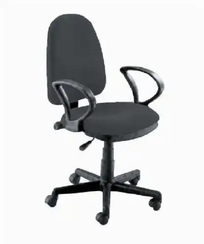

I have a chair like this(shown in figure). I was kneeling on the part where we sit. I just gave a sudden push to the part where we rest the back, without moving my legs. I found that the chair is moving little in the direction I applied the force. I couldn't find any reason why this chair would move forward because I am inside this system and no external force is coming from outside. When I apply the force on it , equal amount of force I am applying there on the seat in the opposite direction, so there should not be any movement.
I tried this experiment again right now. Now holding on the handles of the chair. Did the same thing. Again found the chair moving.
Where I am wrong and how does the chair move?

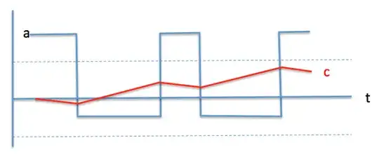

The following diagram might clarify this:
The blue line represents acceleration: when the acceleration exceeds the "minimum" required, the center of mass will barely change (chair moves back, person moves forward). When you move slowly (below the critical acceleration) the center of mass can move (there is a net force on the system from the floor - a small force, but acting for a long time).
