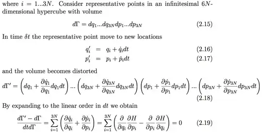

I have found a proof of Liouville's theorem on the internet, which fits me very well except one step I don't understand, the derivation is as follows:
In the derivative, it must have used the relation $dq'_i=dq_i+\frac{\partial\dot{q}_i}{\partial q_i}dq_idt$ and $dp'_i=dp_i+\frac{\partial\dot{p}_i}{\partial p_i}dp_idt$ which I don't understand. Since in the Hamiltonian's formalism, the independent variables are $q$'s and $p$'s, why $dq_i'$ not equal to $dq_i+\sum_j\frac{\partial\dot{q}_i}{\partial q_j}dq_jdt + \sum_j\frac{\partial\dot{q}_i}{\partial p_j}dp_jdt$, etc?

Consider \begin{equation} d\Gamma' = \left( dq_1 + \frac{\partial\dot{q}_1}{\partial q_1}dq_1dt + \cdots + \frac{\partial\dot{q}_1}{\partial p_1}dp_1dt + \cdots \right) \left( dq_2 + \cdots \right) \cdots (dp_1+\cdots)(dp_{3N}+\cdots) \end{equation} where the omitted dots are the remaining terms in your correct expansion \begin{equation} dq'_i = dq_i + \sum_j \frac{\partial\dot{q}_i}{\partial q_j}dq_j dt + \sum_j \frac{\partial\dot{q}_i}{\partial p_j} dp_jdt. \end{equation} Now we want to expand the expression of $d\Gamma'$ up to the first order in $dt$. That means we can only choose one $dt$ term in each bracket. Consider we choose $dt$ factor from the first bracket. If we choose \begin{equation} \frac{\partial\dot{q}_1}{\partial q_1}dq_1dt \end{equation} from the first bracket, then all other brackets should contribute terms like $dq_2,\cdots$ and this leads to your (2.19).
Suppose we instead choose a term in linear $dt$ like \begin{equation} \frac{\partial\dot{q}_1}{\partial p_1}dp_1dt. \end{equation} Again, other brackets should contribute something without $dt$ and these can only be $dq_2,\cdots$ and also the term $dp_1$. However, the volume form is a top form, you can't have $dp_1$ show up twice, therefore, these terms do not contribute.
