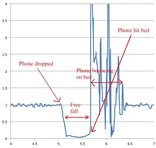

$^1$ Just for fun I did this experiment using the Physics Toolbox app to record the accelerometer readings when I dropped my phone ono my bed, and I got this graph:
Phone accelerometer

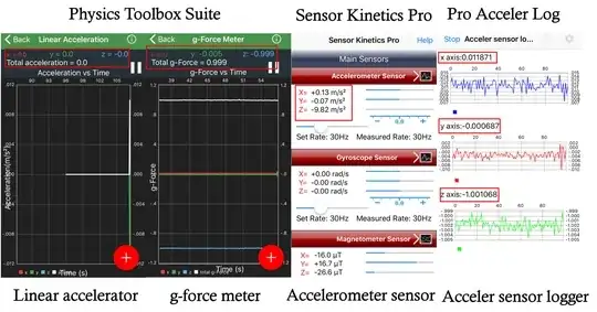

iPhones use the Apple motion coprocessors to collect sensor data from integrated accelerometers, gyroscopes and compasses and offload the collecting and processing of sensor data from the main central processing unit (CPU).
That data is processed by numerous apps in different ways as shown below with an iPhone at rest on a table.
Physics Toolbox Suite has a g-force readout which gives you the "apparent" value of the gravitation field strength (zero when the iPhone is in free fall) and a linear accelerator output which shows the acceleration of the iPhone.
Sensor kinetics pro gives a value for the "apparent" gravitational field strength with a value of zero if the iPhone is in free fall.
Acceleration sensor logger (Pro Acceler Log) also gives a value of the "apparent" gravitation field strength with a value of zero if the iPhone is in free fall.
So you have to interpret the data as you wish.
