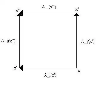

Lattice QCD is define on a grid with spacing $a$, and where on the edgelinks there are gauge potentials. The reciprocal lattice spacings are momentum cut-offs, and must be set so that the heaviest quark mass is $m_q~>>~1/a$. So the lattice spacing is not entirely arbitrary. A discrete difference in gauge potentials defines the fields $$ F_{ij}~=~(A_j(x’)~-~A_i(x”))~-~(A_i(x”’)~-~A_j(x”’))~-~g(A_j(x’)A_i(x”)~-~A_i(x“’)A_j(x“’)) $$ where the coordinates are illustrated in the figure. The internal gauge indices are implied.
This evaluates the gauge potential around a square or plaquette, which is in a large grid. The field is then evaluated as one evaluates a magnetic field as $B~=~-\nabla\times A$ as evaluated in the area of the plaquette. This means the Lagrangian for the quantum system is periodic, and is similar in some ways to a Bloch potential. The limit that one takes the lattice spacing small enough the funny periodic nature of the Lagrangian due to the lattice plays an insignificant role. This is one reason the inverse lattice spacings have to be smaller than the quark masses.
