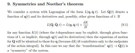

I am studying variational principles and I have been reading this set of notes by Townsend. In the first paragraph of Section 9, Townsend defines what it means for a transformation to be a symmetry of a system:
Section 9
We have $$I[\mathbf Q]=\int_{t_A}^{t_B} L[\mathbf Q, \mathbf {\dot Q}, t]dt=\int_{t_A}^{t_B} L[\mathbf q, \mathbf {\dot q}, t]dt+K(t_B)-K(t_A)=I[\mathbf q]+K(t_B)-K(t_A).$$ However, if $K(t)$ can be any differentiable function and can depend on $\mathbf q(t)$ and its derivatives, I am quite confused as to what it means to say that the equations of motion for $\mathbf Q$ are the same as those for $\mathbf q$ and why this is the case.
