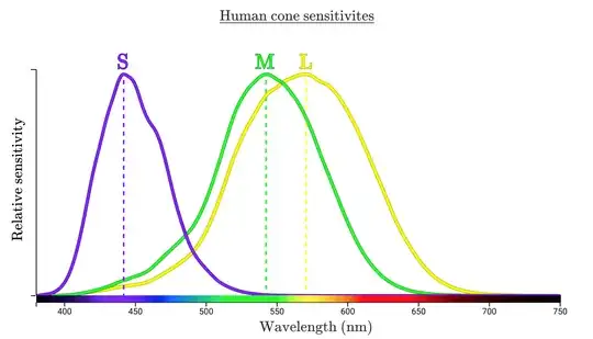

There are different kinds of cones, each of which is sensitive to a certain wavelength region: one sort reacts to blue, one to green and one to yellow/red light. Their response to a wave of a certain wavelength looks as follows (S, M and L correspond to short, medium and long cones):
As you can see, the short cones are not only sensitive to entirely blue light (440nm), but also to some degree to green and violet light. Same goes for all other cones - their responses overlap.

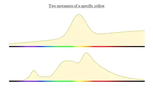

What happens if purely yellow light enters our eye? It is detected by both the medium and long cones and sends an equally strong signal to our brain, which in turn interprets this as yellow. The short cones don't send any signal in this case. The graphs below show two different spectra, but both are recognized by our brain as the same kind of yellow:
Our eyes cannot differentiate between the monochromatic light of e.g. a sodium lamp and a mixture of a red and green light. This principle is exploited in a monitor, where the intensities of the red, blue and green pixels are adjusted to "trick" the eye into thinking a certain color is shown. In reality, only different ratios of these distinct colors arrive at the cones.
