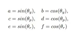

which becomes
according to this
where
which does not make sense.
does it make sense and does it still work in this case?
