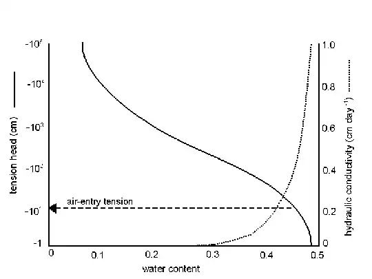

The dashed line in the graph below expresses this fact by showing the hydraulic conductivity (i.e. how fast water infiltrates) as a function of soil moisture (from dry to wet).
http://uregina.ca/~sauchyn/geog327/moisture.gif
