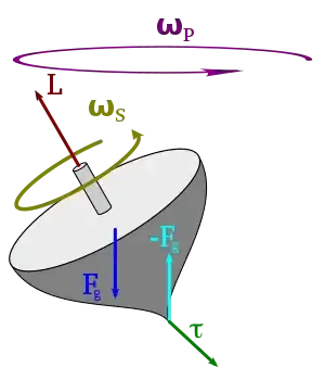

enter image description here (image source: Wikipedia)
There is a net torque (The green vector) about the point of contact due to the gravitational force, which will make the top (and hence its angular momentum vector) precess in the counterclockwise direction as seen from above.
The precession occures due to the following reason: The torque is perpendicular to the axial angular momentum $\vec{L}_s$ (corresponding to $\omega_s$), so it cannot change the magnitude of the $\omega_s$ (hence, that of $\vec{L}_s$). Rather, it will keep changing its direction (just as the centripetal force keeps changing the direction of velocity in uniform circular motion), and the the direction of $\vec{L}_s$ will keep rotating about the vertical axis, i.e. to top will undergo precession.
The angular momentum due to axial rotation does not change in magnitude (as the torque is perpendicular to it), but as precision begins, there will be an additional precessional angular momentum.
