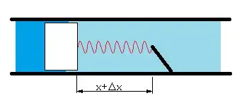

Please take a look at an analogy in a field of water pressure. Let introduce a device built with a piston in a tube connected with a spring. When pressure difference increases, the piston moves and pulls the spring until forces caused by pressure and spring would balance.
water analogy
If we consider pressure difference as an analogy of a voltage, then a volume of water that flows through the pipe would be the electric charge and a ratio of both of them will be analogy of the capacitance.
If we connect both such devices in paralel, then the amounts of water it can 'accumulate' under certain pressure will sum up. So the capacitance will be obviously the sum.
If we connect them in series, the amount of water that manage to flow through them must be the same in all devices in series. The pressure will spread equally between two springs which will cause pulling force to be lower and Δx to be lower. Eventually water volume per pressure will be lower.
Turning back to the field of electricity, it is worth note that electric charge in a link between capacitors will never change because we consider it as isolated. Instead, an electric potential will balance somewhere between potentials of voltage source.
