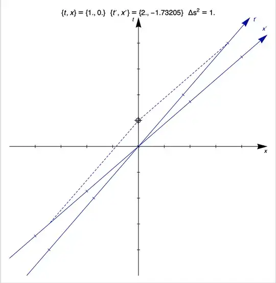

I really wish more books used spacetime diagrams to teach relativity, because 90% of confusion in relativity problems can be resolved by drawing a careful spacetime diagram. The idea is to superimpose the $t$ and $x$ axes for one observer (call them observer B) and the $t'$ and $x'$ axes for a moving observer (observer A) on the same diagram. All events that happen "at the same moment" according to observer B lie along a line parallel to the $x$-axis; all events that happen "at the same moment" according to observer A lie along a line parallel to the $x'$-axis.
Instead of 30 and 60 years, let's use 1 year and 2 years.1 You ask
At one moment, A observes that B has aged only half as himself (say A is aged 60 when he makes the observation and observes B to be 30). How old is B from his own (B's) frame of reference at the moment A made the above observation?
The event we are concerned with in this case (i.e., the point on the spacetime diagram) is the event at which A observes B's age. The key ambiguity in this question is whether "at the moment" means "at the same moment" according to A, or "at the same moment" according to B. If 2 years have elapsed on A's clock when they measure B's age, then "at the moment of the observation" according to A, only 1 year has elapsed:

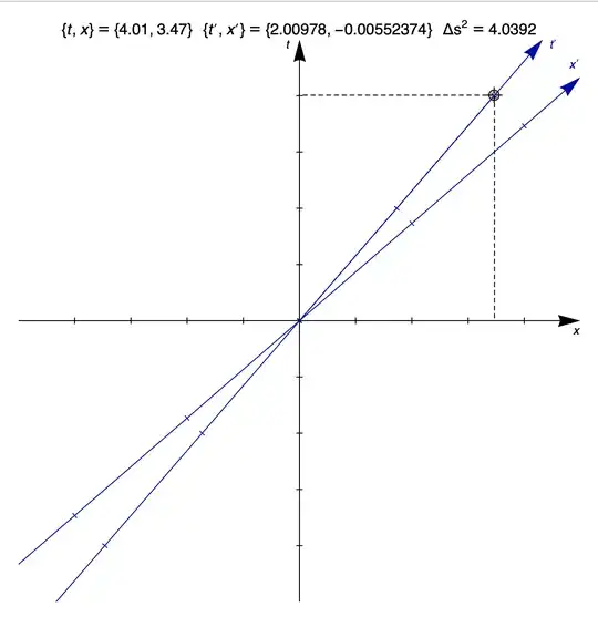

But "at the moment of the observation" according to B, 4 years have elapsed:
The fact that we need to draw different lines to "read off" $t$ and $t'$ is what makes the question a bit ambiguous as stated.
So (returning to the original numbers) to get an unambiguous answer, you can ask either
What is the $t$ coordinate (i.e. the time elapsed as observed by B) of the event where A observes B's age?
in which case the answer is 120 years. Or you can ask
What is the $t'$ coordinate (i.e. the time elapsed as observed by A) of the event where A observes B's age?
in which case the answer is 30 years. So long as you're clear about whether you want to know $t$ or $t'$, there is an unambiguous answer.
