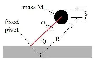

So suppose a top with mass concentrated in a spherical body M of radius S with center situated a distance R to a point a horizontal table at an angle $\theta$ while rotating at angular speed $\omega$. How long does it take for the top to fall over?
Some simplifying assumptions: (1) Assume the point of the top is fixed on the table. (2) Assume that the time at which the top falls over is when $\theta = 0$.
Drawing
