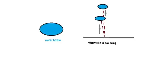

Let's take a small coke bottle (a plastic one). Now fill the bottle entirely with water not even letting a small air bubble, however we cannot stop forming a tiny bubble. Now this water bottle when dropped will bounce of the floor as shown in the image.enter image description here
I think that it became elastic due to the shock waves produced in water due to sudden impulse on the bottle.
However, if the air bubble inside the bottle is somewhat large then it would lose it bouncy nature. I don't know how these waves make this. Could you help me to understand the exact reason behind this?

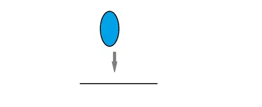

Even the bouncy nature is dependent of configuration of fall. In the given figure if the bottle is allowed to leave at the below given configuration the bottle is not a bouncy one. How could you help me in understanding this phenomenon?enter image description here

It's because if there's an air bubble alot of energy is used to momentarily compress the air on the collision, and subseqent disturbances on the water-air boundary cause a lot of energy disperssion. If you just have a bottle full of water, the dispersion of energy is much smaller and the bounce is more elastic.
As MArtin pointed out in his comment, when a bubble of air is present, a bottle itself may be deformed more easily (since the air is easier to compress than water, it takes less energy for it to change its volume), and the deformation of bottle helps to disperse the energy.
