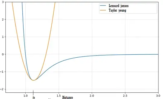

The hooke's law gives an elastic potential energy: $U_s=\frac{1}{2}Kx^2$ because we assume that the force is linear which is a result of a Taylor expansion around the stable distance $r_s$ between two molecules given by the Lennard-Jones potential. enter image description here
