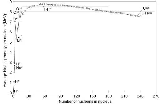

If you have n free protons and m free neutrons , the sum of the masses of the free nucleons is always larger than the same n+m bound in a nucleus.
The difference is what generates this plot:binding energy
It shows against n+m how bound is each nucleon(proton or neutron) within the nucleus. How much energy would be needed to set a nucleon free.
Fission happens to nuclei after Fe to the right in the plot, fusion to light nuclei on the left of F
