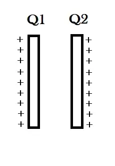

Similar charges always want to get as far away from each other as possible, so they sit on the outer surface of the two conductors. Assuming both are positive it will look like this.

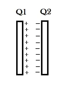

Say $Q_2$ is negative the respective charges will lie on the inner surfaces of the conductors as the two opposite charges attract each other. Like so,
These instances occur purely on the basics of laws of attraction and repulsion.
