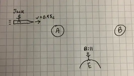

enter image description here Let's say we have an observer named Jack on a spaceship traveling at a constant velocity of 0.95c to the right, according to Bill, who is on the Earth. Then the spaceship reaches planet A and then planet B and keeps moving at constant velocity. The spaceship NEVER accelerates. The 2 events in this problem is Event 1, which is Jack meeting planet A, and Event 2, which is Jack meeting planet B. We give Jack and Bill each a clock and we want to compare the time elapsed between the 2 events that Jack records and the time elapsed between the 2 events that Bill records. My teacher said that Bill records more time for the A to B journey because this is basically the twin paradox. But I disagreed because the problem doesn't involve any acceleration. My argument was that Bill records more time because it's impossible for a single clock at rest relative to Bill to be at the position of Event 1 and at the position of Event 2. However, you CAN have a clock at rest relative to Jack that is at Event 1's position AND Event 2's position. This is the very definition of proper time: time measured by a clock whose position is at the position of both events. Proper time is the shortest measured time, so Bill records more time not because of the twin paradox but because ONLY Jack records the proper time, or shortest time, for these 2 events. Am I correct in my thinking?

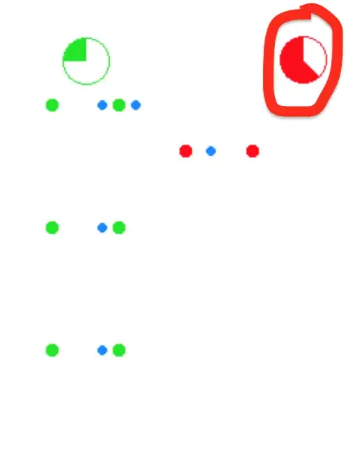

I think I'm getting confused by exactly what the red clock that I circled represents. If we treat the green clock as the time measured by Bill and we choose to have Bill be stationary, the red clock can't represent the time Jack actually measures in his frame then. Rather, the red clock represents the time that Bill THINKS is elapsing for Jack?

The animation below demonstrates change of frames and time dilation:
But who is actually moving and who is actually stationary? You know that, according to Jack's frame of reference, the planets are rushing towards him with $v=-0.95c$.
Strictly speaking, you need to give Jack one clock and Bill two, since Bill needs to record the time of Jack at A and then Jack at B. Anyway, assuming A and B are stationary relative to Bill, then Jack will record less time owing to time dilation. It has nothing to do with the twin paradox.
