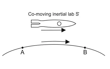

Suppose that, a purely inertial laboratory S’ for a very long time moves tangentially to the circumference on which the ring lies, very near to the AB segment.
How does the anisotropic one – way speed of light on the AB segment can magically turn into isotropic one - way speed of light in the co-moving inertial laboratory S’, as the Einstein’s relativity teaches us?

Short answer: it is anisotropic, but that isn't an inertial frame of reference.
Long answer:
"Frame of reference" in special relativity means "coordinate system". When you talk about a frame of reference you need to be clear about what coordinates you're talking about, including (especially!) the time coordinate.
We keep time on earth by means of a bunch of clocks that are located in various places on the planet, and that we keep synchronized somehow. Let's only worry about clocks at the equator because that's enough for this problem.
Take two adjacent clocks A and B and set them so that the light travel time from A to B and B to A is equal as measured by those clocks. This is called Einstein synchronization and it's how clocks in inertial frames are synchronized. Then adjust C, the clock on the other side of B, so that it's synchronized with B in the same sense. Keep doing this and you'll eventually circumnavigate the globe and get to Z, which is next to A. You'll find that Z and A are not synchronized, and if you try to fix that they'll end up out of sync with Y and/or B. There's a lump under the carpet, and you can push it around but you can't get rid of it.
Let's try a totally different approach: broadcast a light speed signal from the north pole and have each clock set itself to a certain time (say t=0) when it receives that signal. This is essentially how we synchronize most clocks in real life (though the signal often travels over the internet, and the details are much more complicated). It works pretty well. If you look at adjacent pairs of clocks on the equator after this procedure, they'll all be more or less in sync. But none of them will be exactly Einstein synchronized. The lump is still there, it's just evenly distributed around the equator now.
Now, let's take two clocks on the surface, say A and B, and extend them to a line of synchronized clocks extending out into space (tangent to the surface). This is your rocket-ship coordinate system. If you synchronize those clocks pairwise to match the way A and B are synchronized, and A and B were synchronized by the signal from the north pole, then every pair of clocks will be not-quite-Einstein synchronized in the same way as A and B. The speed of light will be anoisotropic as measured by these clocks.
This doesn't contradict special relativity because SR only says that the speed of light is $c$ in inertial reference frames, and this isn't one. Inertial reference frames synchronize their clocks by the Einstein procedure by definition. Your reference frame is a perfectly valid coordinate system, and it might be useful in analyzing the motion of the rocket ship relative to clocks on the ground; it just isn't one of the specific family of coordinate systems that special relativity says the speed of light is $c$ in.
