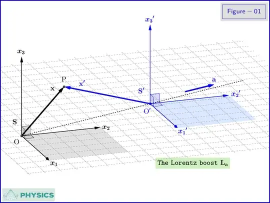

In Figure-01 an inertial system $\:\mathrm S'\:$ is translated with respect to the inertial system $\:\mathrm S\:$ with constant velocity
\begin{equation} \mathbf{a}\boldsymbol{=}\left(\mathrm a_1,\mathrm a_2,\mathrm a_3\right) \,, \qquad \Vert \mathbf{a}\Vert \boldsymbol{=} \mathrm a \in \left(0,c\right) \tag{1-01}\label{1-01} \end{equation} The Lorentz transformation is \begin{align} \mathbf{x}^{\boldsymbol{\prime}} & \boldsymbol{=} \mathbf{x}\boldsymbol{+} \dfrac{\gamma^2_{\mathrm a}}{c^2 \left(\gamma_{\mathrm a}\boldsymbol{+}1\right)}\left(\mathbf{a}\boldsymbol{\cdot} \mathbf{x}\right)\mathbf{a}\boldsymbol{-}\gamma_{\mathrm a}\mathbf{a}\,t \tag{1-02a}\label{1-02a}\\ t^{\boldsymbol{\prime}} & \boldsymbol{=} \gamma_{\mathrm a}\left(t\boldsymbol{-} \dfrac{\mathbf{a}\boldsymbol{\cdot} \mathbf{x}}{c^{2}}\right) \tag{1-02b}\label{1-02b}\\ \gamma_{\mathrm a} & \boldsymbol{=} \left(1\boldsymbol{-}\dfrac{\mathrm a^2}{c^2}\right)^{\boldsymbol{-}\frac12} \tag{1-02c}\label{1-02c} \end{align} in differential form \begin{align} \mathrm d\mathbf{x}^{\boldsymbol{\prime}} & \boldsymbol{=} \mathrm d\mathbf{x}\boldsymbol{+}\dfrac{\gamma^2_{\mathrm a}}{c^2 \left(\gamma_{\mathrm a}\boldsymbol{+}1\right)} \left(\mathbf{a}\boldsymbol{\cdot} \mathrm d\mathbf{x}\right)\mathbf{a}\boldsymbol{-}\gamma_{\mathrm a}\mathbf{a}\,\mathrm dt \tag{1-03a}\label{1-03a}\\ \mathrm dt^{\boldsymbol{\prime}} & \boldsymbol{=} \gamma_{\mathrm a}\left(\mathrm dt\boldsymbol{-} \dfrac{\mathbf{a}\boldsymbol{\cdot} \mathrm d\mathbf{x}}{c^{2}}\right) \tag{1-03b}\label{1-03b} \end{align} and in matrix form \begin{equation} \mathbf{X}^{\boldsymbol{\prime}} \boldsymbol{=} \begin{bmatrix} \mathbf{x}^{\boldsymbol{\prime}}\vphantom{\dfrac{\dfrac{a}{b}}{\dfrac{a}{b}}}\\ c t^{\boldsymbol{\prime}}\vphantom{\dfrac{\dfrac{a}{b}}{\dfrac{a}{b}}} \end{bmatrix} \boldsymbol{=} \begin{bmatrix} \mathrm I\boldsymbol{+}\dfrac{\gamma^2_{\mathrm a}}{c^2 \left(\gamma_{\mathrm a}\boldsymbol{+}1\right)} \mathbf{a}\,\mathbf{a}^{\boldsymbol{\top}} & \boldsymbol{-}\dfrac{\gamma_{\mathrm a}}{c}\mathbf{a} \vphantom{\dfrac{\dfrac{a}{b}}{\dfrac{a}{b}}}\\ \boldsymbol{-}\dfrac{\gamma_{\mathrm a}}{c}\mathbf{a}^{\boldsymbol{\top}} & \hphantom{-}\gamma_{\mathrm a}\vphantom{\dfrac{\dfrac{a}{b}}{\dfrac{a}{b}}} \end{bmatrix} \begin{bmatrix} \mathbf{x}\vphantom{\dfrac{\dfrac{a}{b}}{\dfrac{a}{b}}}\\ c t\vphantom{\dfrac{\dfrac{a}{b}}{\dfrac{a}{b}}} \end{bmatrix} \boldsymbol{=} \mathrm L_{\mathrm a}\mathbf{X} \tag{1-04}\label{1-04} \end{equation} where $\:\mathrm L_{\mathrm a}\:$ the real symmetric $\:4\times 4\:$ matrix \begin{equation} \mathrm L_{\mathrm a} \boldsymbol{\equiv} \begin{bmatrix} \mathrm I\boldsymbol{+}\dfrac{\gamma^2_{\mathrm a}}{c^2 \left(\gamma_{\mathrm a}\boldsymbol{+}1\right)} \mathbf{a}\,\mathbf{a}^{\boldsymbol{\top}} & \boldsymbol{-}\dfrac{\gamma_{\mathrm a}}{c}\mathbf{a} \vphantom{\dfrac{\dfrac{a}{b}}{\dfrac{a}{b}}}\\ \boldsymbol{-}\dfrac{\gamma_{\mathrm a}}{c}\mathbf{a}^{\boldsymbol{\top}} & \hphantom{-}\gamma_{\mathrm a}\vphantom{\dfrac{\dfrac{a}{b}}{\dfrac{a}{b}}} \end{bmatrix} \tag{1-05}\label{1-05} \end{equation}

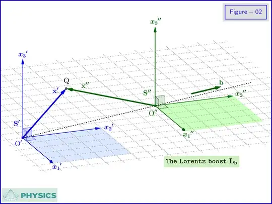

In Figure-02 an inertial system $\:\mathrm S''\:$ is translated with respect to the inertial system $\:\mathrm S'\:$ of Figure-01 with constant velocity \begin{equation} \mathbf{b}\boldsymbol{=}\left(\mathrm b_1,\mathrm b_2,\mathrm b_3\right) \,, \qquad \Vert \mathbf{b}\Vert \boldsymbol{=} \mathrm b \in \left(0,c\right) \tag{1-06}\label{1-06} \end{equation} The Lorentz transformation is \begin{align} \mathbf{x}^{\boldsymbol{\prime\prime}} & \boldsymbol{=} \mathbf{x}^{\boldsymbol{\prime}}\boldsymbol{+} \dfrac{\gamma^2_{\mathrm b}}{c^2 \left(\gamma_{\mathrm b}\boldsymbol{+}1\right)}\left(\mathbf{b}\boldsymbol{\cdot} \mathbf{x}^{\boldsymbol{\prime}}\right)\mathbf{b}\boldsymbol{-}\gamma_{\mathrm b}\mathbf{b}\,t^{\boldsymbol{\prime}} \tag{1-07a}\label{1-07a}\\ t^{\boldsymbol{\prime\prime}} & \boldsymbol{=} \gamma_{\mathrm b}\left(t^{\boldsymbol{\prime}}\boldsymbol{-} \dfrac{\mathbf{b}\boldsymbol{\cdot} \mathbf{x}^{\boldsymbol{\prime}}}{c^{2}}\right) \tag{1-07b}\label{1-07b}\\ \gamma_{\mathrm b} & \boldsymbol{=} \left(1\boldsymbol{-}\dfrac{\mathrm b^2}{c^2}\right)^{\boldsymbol{-}\frac12} \tag{1-07c}\label{1-07c} \end{align} in differential form \begin{align} \mathrm d\mathbf{x}^{\boldsymbol{\prime\prime}} & \boldsymbol{=} \mathrm d\mathbf{x}^{\boldsymbol{\prime}}\boldsymbol{+} \dfrac{\gamma^2_{\mathrm b}}{c^2 \left(\gamma_{\mathrm b}\boldsymbol{+}1\right)}\left(\mathbf{b}\boldsymbol{\cdot} \mathrm d\mathbf{x}^{\boldsymbol{\prime}}\right)\mathbf{b}\boldsymbol{-}\gamma_{\mathrm b}\mathbf{b}\,\mathrm dt^{\boldsymbol{\prime}} \tag{1-08a}\label{1-08a}\\ \mathrm dt^{\boldsymbol{\prime\prime}} & \boldsymbol{=} \gamma_{\mathrm b}\left(\mathrm dt^{\boldsymbol{\prime}}\boldsymbol{-} \dfrac{\mathbf{b}\boldsymbol{\cdot} \mathrm d\mathbf{x}^{\boldsymbol{\prime}}}{c^{2}}\right) \tag{1-08b}\label{1-08b} \end{align} and in matrix form \begin{equation} \mathbf{X}^{\boldsymbol{\prime\prime}} \boldsymbol{=} \begin{bmatrix} \mathbf{x}^{\boldsymbol{\prime\prime}}\vphantom{\dfrac{\dfrac{a}{b}}{\dfrac{a}{b}}}\\ c t^{\boldsymbol{\prime\prime}}\vphantom{\dfrac{\dfrac{a}{b}}{\dfrac{a}{b}}} \end{bmatrix} \boldsymbol{=} \begin{bmatrix} \mathrm I\boldsymbol{+}\dfrac{\gamma^2_{\mathrm b}}{c^2 \left(\gamma_{\mathrm b}\boldsymbol{+}1\right)} \mathbf{b}\,\mathbf{b}^{\boldsymbol{\top}} & \boldsymbol{-}\dfrac{\gamma_{\mathrm b}}{c}\mathbf{b} \vphantom{\dfrac{\dfrac{a}{b}}{\dfrac{a}{b}}}\\ \boldsymbol{-}\dfrac{\gamma_{\mathrm b}}{c}\mathbf{b}^{\boldsymbol{\top}} & \hphantom{-}\gamma_{\mathrm b}\vphantom{\dfrac{\dfrac{a}{b}}{\dfrac{a}{b}}} \end{bmatrix} \begin{bmatrix} \mathbf{x}^{\boldsymbol{\prime}}\vphantom{\dfrac{\dfrac{a}{b}}{\dfrac{a}{b}}}\\ c t^{\boldsymbol{\prime}}\vphantom{\dfrac{\dfrac{a}{b}}{\dfrac{a}{b}}} \end{bmatrix} \boldsymbol{=} \mathrm L_{\mathrm b}\mathbf{X}^{\boldsymbol{\prime}} \tag{1-09}\label{1-09} \end{equation} where $\:\mathrm L_{\mathrm b}\:$ the real symmetric $\:4\times 4\:$ matrix \begin{equation} \mathrm L_{\mathrm b} \boldsymbol{\equiv} \begin{bmatrix} \mathrm I\boldsymbol{+}\dfrac{\gamma^2_{\mathrm b}}{c^2 \left(\gamma_{\mathrm b}\boldsymbol{+}1\right)} \mathbf{b}\,\mathbf{b}^{\boldsymbol{\top}} & \boldsymbol{-}\dfrac{\gamma_{\mathrm b}}{c}\mathbf{b} \vphantom{\dfrac{\dfrac{a}{b}}{\dfrac{a}{b}}}\\ \boldsymbol{-}\dfrac{\gamma_{\mathrm b}}{c}\mathbf{b}^{\boldsymbol{\top}} & \hphantom{-}\gamma_{\mathrm b}\vphantom{\dfrac{\dfrac{a}{b}}{\dfrac{a}{b}}} \end{bmatrix} \tag{1-10}\label{1-10} \end{equation}

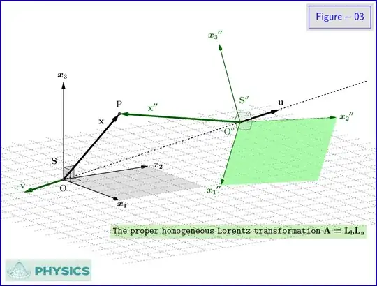

For the composition of the Lorentz boosts $\:\mathrm L_{\mathrm a}\:$ and $\:\mathrm L_{\mathrm b}$, equations \eqref{1-05} and \eqref{1-10} respectively, we have
\begin{equation} \mathbf{X}^{\boldsymbol{\prime\prime}} \boldsymbol{=} \mathrm L_{\mathrm b}\mathbf{X}^{\boldsymbol{\prime}}\boldsymbol{=}\mathrm L_{\mathrm b}\mathrm L_{\mathrm a}\mathbf{X}\boldsymbol{=}\Lambda \mathbf{X} \tag{2-01}\label{2-01} \end{equation} so \begin{equation} \Lambda \boldsymbol{\equiv}\mathrm L_{\mathrm b}\mathrm L_{\mathrm a} \tag{2-02}\label{2-02} \end{equation} that is
\begin{align} \Lambda \boldsymbol{\equiv}\mathrm L_{\mathrm b}\mathrm L_{\mathrm a} & \boldsymbol{=} \begin{bmatrix} \begin{array}{ccc|c} & & & \vphantom{\dfrac{a}{b}}\\ & \mathrm I\boldsymbol{+}\dfrac{\gamma^2_{\mathrm b}}{c^2 \left(\gamma_{\mathrm b}\boldsymbol{+}1\right)} \mathbf{b}\mathbf{b}^{\boldsymbol{\top}} & & \boldsymbol{-}\dfrac{\gamma_{\mathrm b}}{c}\mathbf{b}\vphantom{\dfrac{a}{b}}\\ & & & \vphantom{\dfrac{a}{b}}\\ \hline & \boldsymbol{-}\dfrac{\gamma_{\mathrm b}}{c}\mathbf{b}^{\boldsymbol{\top}} & & \gamma_{\mathrm b} \vphantom{\dfrac{\tfrac{a}{b}}{b}} \end{array} \end{bmatrix} \begin{bmatrix} \begin{array}{ccc|c} & & & \vphantom{\dfrac{a}{b}}\\ & \mathrm I\boldsymbol{+}\dfrac{\gamma^2_{\mathrm a}}{c^2 \left(\gamma_{\mathrm a}\boldsymbol{+}1\right)} \mathbf{a}\mathbf{a}^{\boldsymbol{\top}} & & \boldsymbol{-}\dfrac{\gamma_{\mathrm a}}{c}\mathbf{a}\vphantom{\dfrac{a}{b}}\\ & & & \vphantom{\dfrac{a}{b}}\\ \hline & \boldsymbol{-}\dfrac{\gamma_{\mathrm a}}{c}\mathbf{a}^{\boldsymbol{\top}} & & \gamma_{\mathrm a} \vphantom{\dfrac{\tfrac{a}{b}}{b}} \end{array} \end{bmatrix} \nonumber\\ &\boldsymbol{=} \begin{bmatrix} \begin{array}{ccc|c} & & & \vphantom{\dfrac{a}{b}}\\ & \mathrm R\boldsymbol{+}\dfrac{\gamma^2}{c^2 \left(\gamma\boldsymbol{+}1\right)}\mathbf v \mathbf u^{\boldsymbol{\top}} & & \boldsymbol{-}\dfrac{\gamma}{c}\mathbf v\vphantom{\dfrac{a}{b}}\\ & & & \vphantom{\dfrac{a}{b}}\\ \hline & \boldsymbol{-}\dfrac{\gamma}{c}\mathbf u^{\boldsymbol{\top}} & & \gamma \vphantom{\dfrac{\tfrac{a}{b}}{b}} \end{array} \end{bmatrix} \tag{2-03a}\label{2-03a}\\ &\hphantom{\boldsymbol{=}=}\texttt{where }\gamma_{\mathrm u} \boldsymbol{=} \left(1\boldsymbol{-}\dfrac{\mathrm u^2}{c^2}\right)^{\boldsymbol{-}\frac12}\boldsymbol{=}\gamma \boldsymbol{=}\left(1\boldsymbol{-}\dfrac{\mathrm v^2}{c^2}\right)^{\boldsymbol{-}\frac12}\boldsymbol{=}\gamma_{\mathrm v} \tag{2-03b}\label{2-03b} \end{align} The last expression is due to the fact that $\:\Lambda \boldsymbol{\equiv}\mathrm L_{\mathrm b}\mathrm L_{\mathrm a}\:$ is a proper homogeneous Lorentz transformation and as such one it must have a form as in the right most side of equation \eqref{1-13}. Hence \begin{align} \mathrm R\boldsymbol{+}\dfrac{\gamma^2}{c^2 \left(\gamma\boldsymbol{+}1\right)}\mathbf v \mathbf u^{\boldsymbol{\top}} & \boldsymbol{=}\left[\mathrm I\boldsymbol{+}\dfrac{\gamma^2_{\mathrm b}}{c^2 \left(\gamma_{\mathrm b}\boldsymbol{+}1\right)} \mathbf{b}\mathbf{b}^{\boldsymbol{\top}}\right]\left[\mathrm I\boldsymbol{+}\dfrac{\gamma^2_{\mathrm a}}{c^2 \left(\gamma_{\mathrm a}\boldsymbol{+}1\right)} \mathbf{a}\mathbf{a}^{\boldsymbol{\top}} \right]\boldsymbol{+}\dfrac{\gamma_{\mathrm a}\gamma_{\mathrm b}}{c^2}\mathbf{b}\mathbf{a}^{\boldsymbol{\top}} \tag{2-04a}\label{2-04a}\\ \boldsymbol{-}\dfrac{\gamma}{c}\mathbf v & \boldsymbol{=}\left[\mathrm I\boldsymbol{+}\dfrac{\gamma^2_{\mathrm b}}{c^2 \left(\gamma_{\mathrm b}\boldsymbol{+}1\right)} \mathbf{b}\mathbf{b}^{\boldsymbol{\top}}\right]\biggl(\boldsymbol{-}\dfrac{\gamma_{\mathrm a}}{c}\mathbf{a} \biggr)\boldsymbol{-}\dfrac{\gamma_{\mathrm a}\gamma_{\mathrm b}}{c}\mathbf{b} \tag{2-04b}\label{2-04b}\\ \boldsymbol{-}\dfrac{\gamma}{c}\mathbf u^{\boldsymbol{\top}} & \boldsymbol{=}\biggl(\boldsymbol{-}\dfrac{\gamma_{\mathrm b}}{c}\mathbf{b}^{\boldsymbol{\top}} \biggr)\left[\mathrm I\boldsymbol{+}\dfrac{\gamma^2_{\mathrm a}}{c^2 \left(\gamma_{\mathrm a}\boldsymbol{+}1\right)} \mathbf{a}\mathbf{a}^{\boldsymbol{\top}} \right]\boldsymbol{-}\dfrac{\gamma_{\mathrm a}\gamma_{\mathrm b}}{c}\mathbf{a}^{\boldsymbol{\top}} \tag{2-04c}\label{2-04c}\\ \gamma & \boldsymbol{=}\gamma_{\mathrm a}\gamma_{\mathrm b}\biggl(1\boldsymbol{+}\dfrac{\mathbf{a}\boldsymbol{\cdot}\mathbf{b}}{c^2}\biggr) \tag{2-04d}\label{2-04d} \end{align} Now, the program will run as follows. The scalar $\:\gamma\:$ is determined from \eqref{2-04d} as function of the boost velocities $\:\mathbf a\:$ and $\:\mathbf b$. Given this we determine the 3-vectors $\:\mathbf v\:$ and $\:\mathbf u\:$ from equations \eqref{2-04b} and \eqref{2-04c} respectively again as functions of the boost velocities $\:\mathbf a\:$ and $\:\mathbf b$. Finally using these expressions of $\:\gamma,\mathbf v,\mathbf u\:$ we'll determine the matrix $\:\mathrm R$ from equation \eqref{2-04a}.

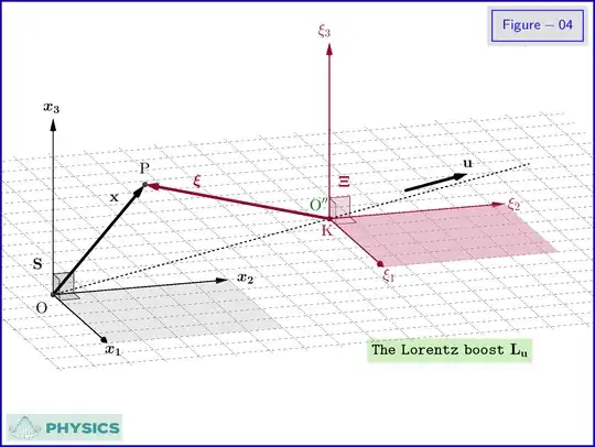

\begin{equation} \rm L\left(\boldsymbol{-}\mathbf u\right)\mathcal R^{\boldsymbol{-}1}\boldsymbol{=}\Lambda^{\boldsymbol{-}1}\boldsymbol{=}\mathcal R^{\boldsymbol{-}1}\, \rm L\left(\boldsymbol{-}\mathbf v\right) \tag{3-05}\label{3-05} \end{equation} In Figure-04 the system $\:\mathrm S\:$ is transformed under the Lorentz boost $\:\rm L\left(\mathbf u\right) \:$ to the system $\:\Xi$. The latter is at rest with respect to the system $\:\mathrm S''$ to which is transformed by the pure rotation $\:\mathcal R$.
