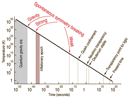

  • After 10 seconds of Big Bang, most of the leptons and antileptons annihilate each other leading to an outburst of photons. The universe was said to be dominated by photons resembling a glowing fog. This plot shows a linear decrease in temperature since the beginning. Can we get an estimation from the energy density or temperature as to how bright was the universe during photon epoch (i.e. if $t = 0$ denotes the onset of Big Bang, then from $t = 10$ seconds to $t = 370,000$ years, at the beginning of dark ages)? Brightness can be quantified in terms of "magnitude".
  • Follow-up question: It is estimated that the first stars began to shine around approximately $200-300$ million years from the moment of Big Bang. However, the temperature of the universe has died down by more than $30$ orders of magnitude since then. Assuming that there are $100$ billion stars per galaxy, it is estimated here that there would be $2 \times 10^{23}$ stars in the observable universe now. Is there a meaningful way to compare the brightness of the universe during photon epoch and now?

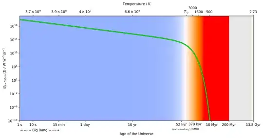

Brightness and color through the history of the Universe
The figure below shows, in green, the brightness of the CMB as a function of time after the Big Bang. A secondary $x$ axis on top show the corresponding temperature of the Universe. The background color shows the color of the Universe as would be perceived by a human being, calculated by convolving the spectrum of the radiation with the response function of the human eye: The first few tens of thousands of years, the Universe is a pale sapphire blue, turning white as it reaches the temperature of the Sun ($T_\odot \simeq 5\,780\,\mathrm{K}$). At $t\sim200\,\mathrm{Myr}$, stars begin to form and the calculation of the spectrum becomes more complicated (so I've grayed it it out), but today the Universe has reached a cosmic latte (Baldry et al. 2002). Note that, as mentioned above, only between $t\sim1\,\mathrm{Myr}$ and $t\sim6\,\mathrm{Myr}$ — where the temperatures was $1600\mathrm{K} \gtrsim T \gtrsim 500\mathrm{K}$ — could you actually see anything; prior to this epoch you'd go blind, and after this epoch, it'd be too dim (but you could in principle still see the color using sunglasses/binoculars, respectively).
UniverseColor
At $T\lesssim hc/\lambda k_\mathrm{B} \simeq 30\,000\,\mathrm{K}$ the exponential factor in the Planck law blows up so the brightness at $\lambda$ quickly decreases. The brightness is further decreased by the fact that, at $t\sim52\,\mathrm{kyr}$, the Universe transitions from being radiation-dominated to being matter-dominated and so the expansion goes from $a(t)\propto t^{1/2}$ to $a(t)\propto t^{2/3}$, i.e. faster.
At the time of recombination ($t\sim379\,\mathrm{kyr}$), the Universe is somewhat brighter than at $t\sim1\,\mathrm{Myr}$. Here, $T\sim3000\,\mathrm{K}$, so $B_\lambda(550\,\mathrm{nm},3000\,\mathrm{K}) = 3\times 10^{10}\,\mathrm{W}\,\mathrm{m}^{-3}\,\mathrm{sr}^{-1}$, or a billion times less bright than at $t\simeq10\,\mathrm{s}$.
