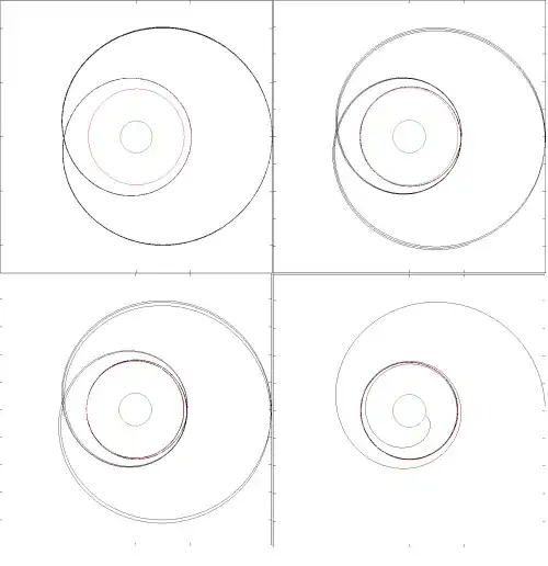

The resulting orbits from using this expression is close to what is expected from GR but not quite right, I think it could be improved. In the plot of numerical integrations using the last expression below the green circle represents the Schwarzschild radius and the red circle represents the innermost stable circular orbit.
Orbits closing in and passing the ISCO
