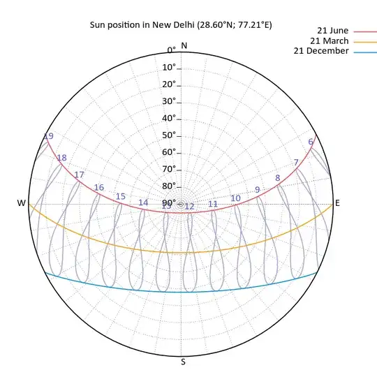

Azimuth
Panels are usually oriented towards the south in the northern hemisphere because the sun mostly is in the southern part of the sky. The sun sometimes is in the northern part of the sky, e.g. during sunrise and sunset in spring and in summer. It only happens when the sun is relatively low so it doesn't have a huge influence on the total yield.
Here's a sun-path diagram for New Delhi (28.6°N, Northern India):

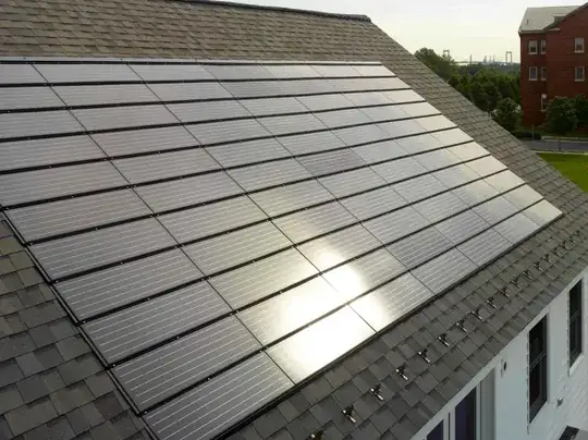

When solar panels are installed on buildings, they sometimes have to be integrated directly in the roof, so the orientation will be dictated by the architecture.

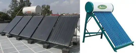

It could be about right for hot water production:

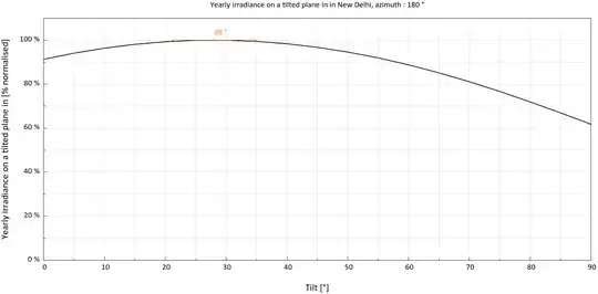

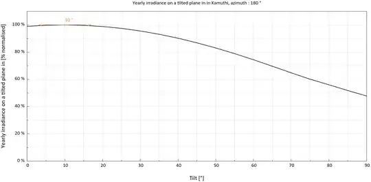

Here's an average irradiance vs tilt diagram for New-Delhi (28.6°N):
and for Kamuthi (9.3°N):
In both case, the curves are pretty flat around the maximum, so the tilt angle could be chosen to be 20° or 25° in New-Delhi in order to avoid shadows. It shouldn't be much flatter than 10° in Kamuthi in order to avoid soiling.

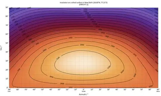

Azimuth & Tilt
North India
Here are contour lines for yearly insolation vs orientation in New-Delhi:
Unsurprisingly, the orientation with the highest yearly yield is towards the South with a tilt between 25° and 30°, for an insolation of almost $2150\mathrm{\frac{kWh}{m².a}}$.

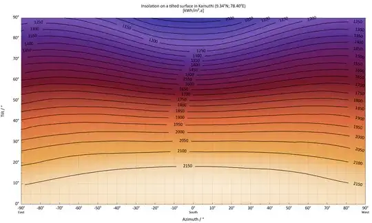

South India
Kamuthi is so close to the equator that the azimuth doesn't matter much, as long as the tilt angle is low. If the tilt angle is higher (e.g. around 60° for solar thermal collectors), it's actually better to orient the panel towards the East or West than towards the South.

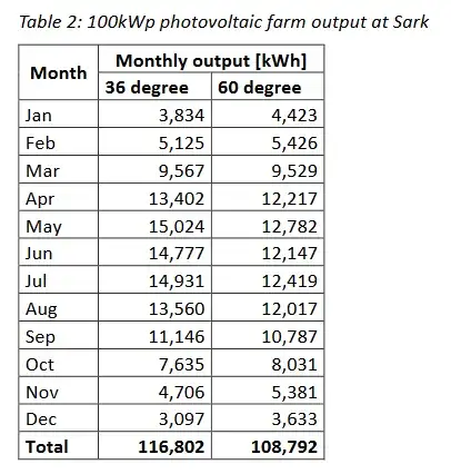

Its because the sun is never quite in the same part of the sky during the year. Different tilts will generate more energy at different times of year - eg a report for the island of Sark gave 2 tilt options:
So 60 degree tilt gives more in winter, but less in summer, with a small loss of total efficiency. No doubt India is different for solar generation, but that could be why panels are tilted like they are.
