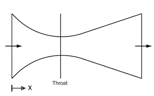

Consider flow through the converging and diverging portions of a tube with varying radius: enter image description here
In inviscid flow, Bernoulli's equation states that velocity at the throat will be the highest, so this area will have the lowest pressure.
If the flow is viscous and locally fully developed throughout, however, then my intuition says that the throat will have the highest pressure. Is this true?
I reason this is true because the volume flow rate $Q$ must stay constant in an incompressible flow. If the flow is locally fully developed at each point $x$, then the flow rate is:
$$ Q = \frac{\pi R^4}{8 \mu}(\frac{-dP}{dx})$$
As $R(x)$ decreases, then $\frac{-dP}{dx}$ must increase in the algebraic sense. The only way this is possible, and to keep pressure continuity at the throat, is if the pressure distribution has a maximum at the throat.
Does viscous flow through a nozzle result in an increase in pressure, opposite of what inviscid flow predicts?
