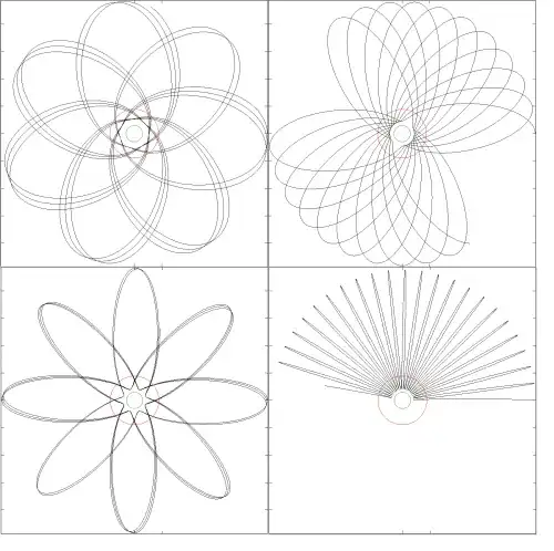

The expression that is actually used by JPL to calculate/approximate the relativistic effects under given promises comes from the "post-Newtonian expansion" at the 1PN-level and, including the classical Newtonian acceleration, it looks like:
$$\frac{d\bar{v}}{dt}=-\frac{GM}{r^2}\left(1-\frac{4GM}{rc^2}+\frac{v^2}{c^2}\right)\hat{r} +\frac{4GM}{r^2}\left(\hat{r}\cdot \hat{v}\right)\frac{v^2}{c^2}\hat{v}$$
So they are basically introducing one component that is "repulsive inverse cube gravity" and two velocity dependent terms. This expression is also availabe at the 3PN-level, see this post. Note that this is only an approximation that is able to reproduce the "anomalous perihelion shift" in the weak field limit. The extra repulsive inverse cube term causes very strange behaviour if you try to use it in the strong field limit. Here are a few simulations I made where the green circle denotes the Schwarzschild radius and the red circle denotes the radial distance to the "innermost stable circular orbit." It is easy to see the bouncing caused by the repulsive inverse cube term:
Note: This is the expression for the case of infinite mass ratio. If you cannot use the infinite mass ratio approximation, the expression would be more complicated I think.
